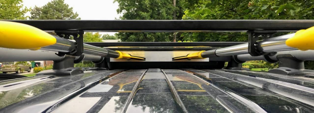

I thought I should follow up on this. We went on a >500 mile camping trip this past weekend and I wanted the paddles up top, but not in the way of loading / unloading the canoe. Here’s what I came up with last week.
I used some aluminum angle at 1.5" x 2.5" x .125" thick, some rubber trim and a couple of mini quick fists. Bolted these to the bottom of my strut crossbars and it worked great for our trip.
We have a smaller third paddle that I may add a slot for, but it’s short enough to fit inside behind the rear seats so not really necessary to keep it up on the roof.
