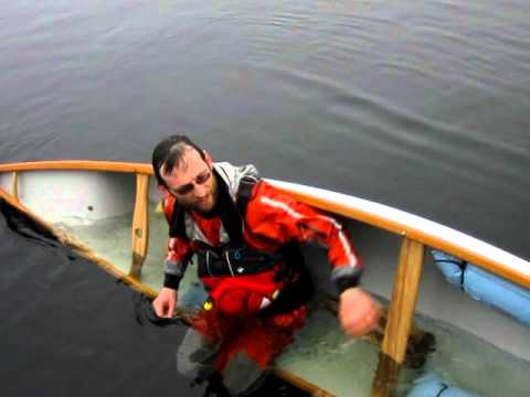

interesting system he has developed. Using water in a bag as a counter weight a nifty idea.

Thanks for the video I watched one of his a while back likely the one before this one and he was filling his bag and hanging it but didn’t have the side float bags in. In that video I thought he had too much of the bag in the water. What he needs it to get it higher and on a longer arm to counter his weight? I picture a telescoping thwart that you could pull out and hang a water bag from or stick a float on. I know it can be done with a paddle and tying it around the boat and such but a guy like this guy that is out in the open channel alone in cold water needs something fast and sure already rigged to go. Putting buckets into bags and filling and sealing them sounds like a lot of time messing around especially when he first flipped the boat with his side bags he didn’t have much water in there most of it came in when he pressed with his weight getting in. Seems like something rigged to flip out with a float ready to go and a stirrup and he could be back in quick.

I converted that OT147 to a solo so I have loads of room on both sides I don’t really use with sitting in the center. For me a high up inside sponson would do the job keeping scooped water out. Then I get to thinking the bolt on ones on the outside will work too. Seems like with outside sponsons most of the time the canoe won’t flip all the way over even if you do go out. I don’t know for sure though. :canoe:
Here are a couple vids of side bags. I’m looking for a vid of flipping a canoe with foam sponsons if anyone knows of one?

Here are a couple more videos of side bags and how they work.
Figuring out how to lace them in and not having something so wide as to not be practical in a solo seat configuration is what I have been working on. In many ways the idea of sponsons on the outside solve a lot of problems. They do make a wide canoe even wider and can cause something to snag against them if you run areas where you are not out in open waters.
The ideal thing would be tall thin floatation that would fit down each side and be curved to a shape like the hull and readily attached without adding much weight. I’m a little surprised some company hasn’t made something like that to fit their canoes perfectly.
