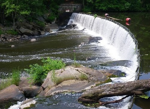

Wow - by that definition almost every dam around here is a low head dam. There are 11 dams on the RI section of my home river the Blackstone, and all but two (Woonsocket Falls - an ACE Flood Control Dam, and Pratt Dam - unblocked tubes through the dam) would be low head dams.
Most of the pictures are in low water, but every one of them is dangerous if you approach from the bottom. I can only think of one fatality with these dams - father and son in a tandem canoe dumped trying the run the tubes at the Pratt Dam and the son got hung up in debris and drowned.
