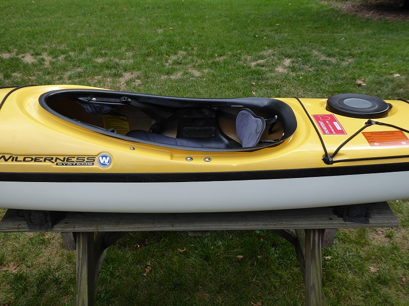

I took the kayak on a maiden voyage today on a glass-calm lake. It paddles nice and I never thought about the seat so that must mean it’s comfortable. So, looks like my fleet has grown.
There were no leaks and my feet rub further forward, so I can wait for a crappy day to do the patch. I’ll use epoxy resin and fiberglass cloth that I already have (not sure of the weight, but as Paddledog said, it’s not going into space). I like rstevens15s idea of a little painters tape to edge the final layer of epoxy to make a neater job so I’ll do that too.
Here are a couple of additional photos of the kayak. It’s amazing how good the hull and deck look considering it’s a 2004. Not bad for $500 and it was only an hour’s drive from me.
It’s a great looking boat. Don’t worry about the repair. It will go fine and the boat will be as strong as new afterwards.
You scored, enjoy :laughing:

This thread kind of migrated to a general advice discussion on what materials and methods to use for a small repair. So, I figure I’ll post what I’ve done to patch the two worn spots that started the discussion. This is what I did, not necessarily the right thing to do or the best way to do it. I’m sure I’ll get some advice on things I might have done better.
I scraped the worn area gently with a carbide scraper, but found that too much scraping on the edges just enlarged the radius of the frayed area. I then cleaned the area of the hull with a little acetone (since I have some) and then a wipe with isopropyl rubbing alcohol. I used 6 oz fiberglass cloth and 5:1 epoxy resin which I already had. I made a small oval patch to roughly fill in the middle of each worn spot and then a 3.5 x 6.5 inch patch, cut on a 45 degree bias, over that. The rectangle covered the entire worn area. I fiber glassed those in one application, and squeegeed the patch to try to push out any air bubbles.
After it all cured, I scraped the edges a bit with the carbide scraper, cleaned with a little soap and water and then isopropyl to get rid of any amine bluish. I then applied a larger 8 x 10 inch patch over the whole area. I had a piece of brown craft paper with a 10 x 12 opening taped down to neaten the edges and protect from drips. Same process as step one: wet the area with resin, apply patch, saturate patch, squeegee out air, smooth out resin with brush.
The temperature for both steps was in the low 70s with moderate humidity, so I used a fast hardener, and for the final step I’m also applying gentle heat with a 40 watt incandescent bulb. I have a temperature probe near the patch that’s reading 81 deg F (thin white wire in the photo).
Here’s a photo. It’s curing now.
It looks fine and will be a good repair.
