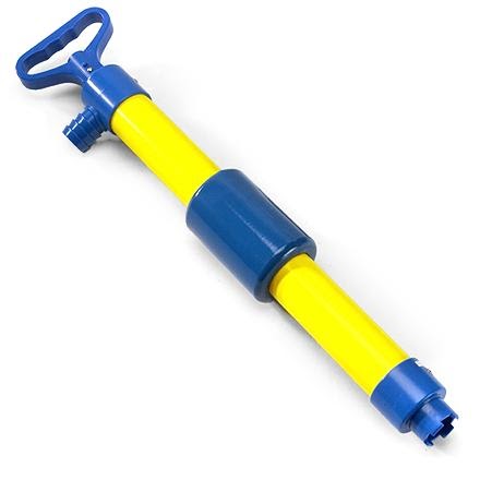

I wish someone made a waterproof electric hand (i.e., hand-held vs mounted) kayak pump
I always thought the best of both worlds would be a permanently installed electric pump on your own boat, with a detachable hose to be able to pump out a second boat if needed, like a modern vacuum cleaner with detachable hoses and functions.
