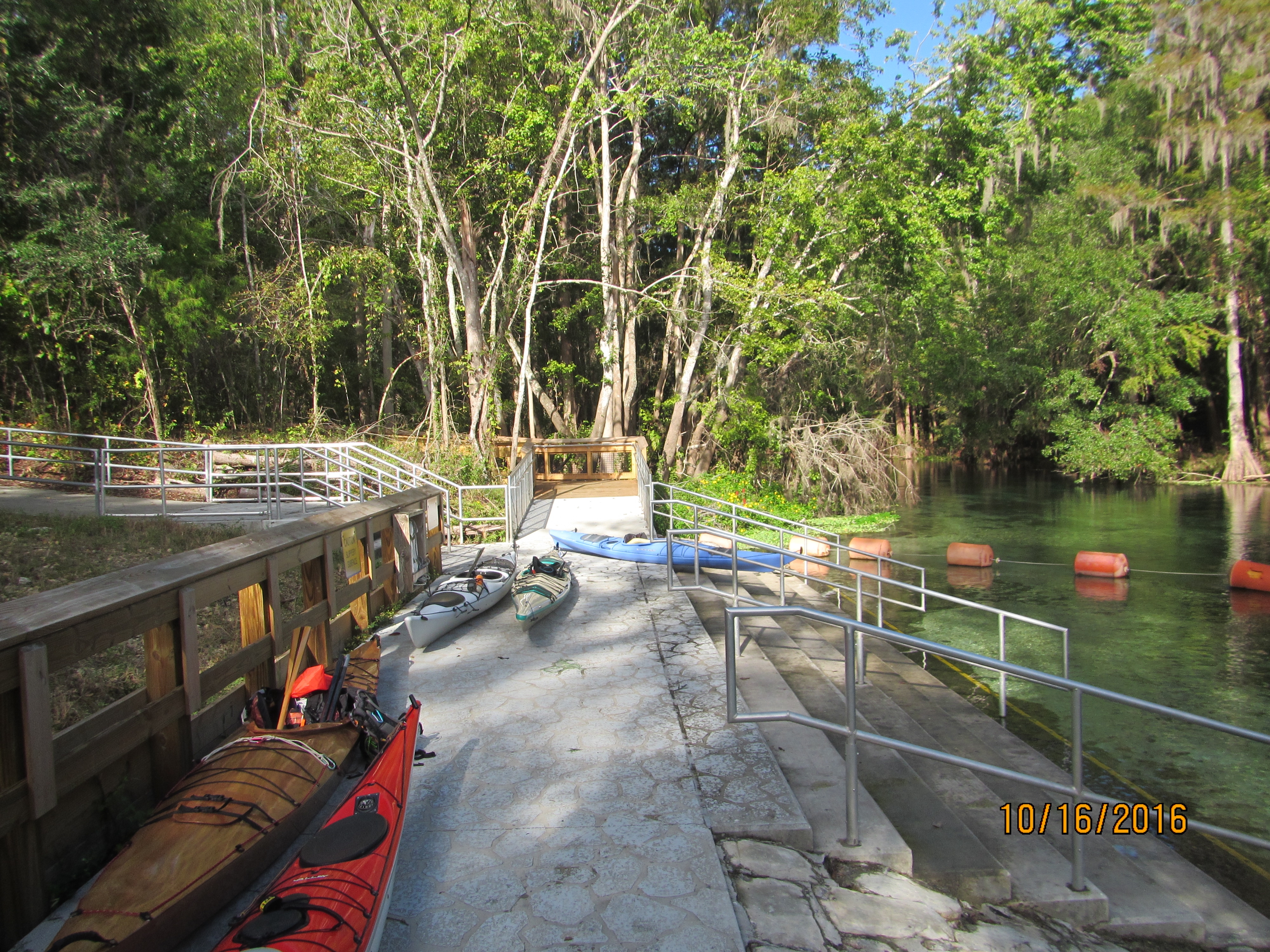

At a river camp the state put stairs down to deep water. So you have to get out of your heavy laden boat and carry it up the stairs to the boat racks. Not good. I must admit though the ramp in the picture makes loading the kayak on carts at the water and wheeling it up to the parking area convenient.
