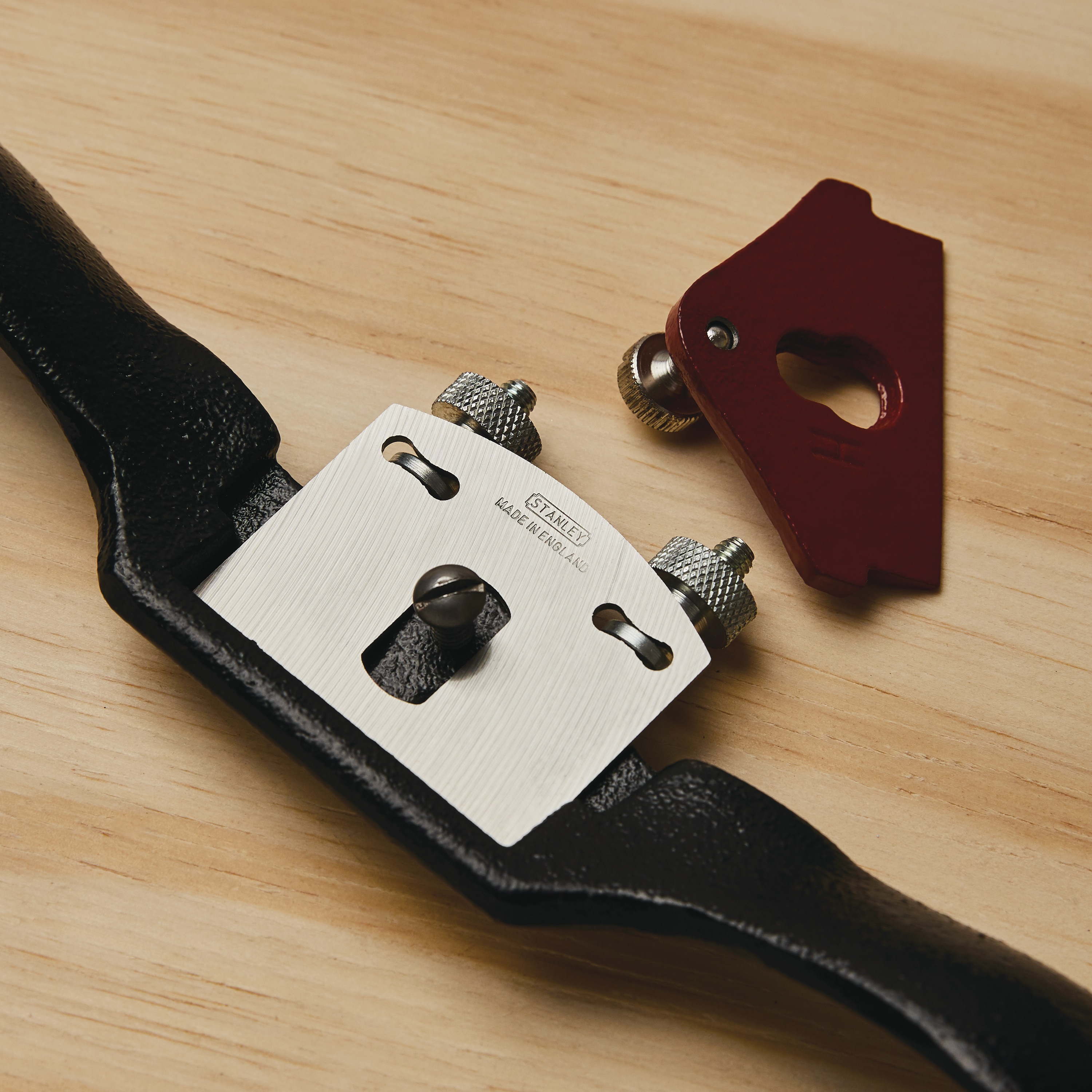

OK, here’s the scoop on the Stanley 12-951:
I had done a relatively quick tune-up on it and I decided to do a bit more work. I resharpened the blade, sanded the paint - which is thick and durable - off the cap’s contact point with the blade and also off the front edge of the cap. The metal is very hard and a file wouldn’t bite into it, so it may actually be chromed under the paint. The cap is actually thicker than the Record cap, but some of the difference is the paint; the metal thickness is probably the same.
I tried it on some pine and cherry and it tended to chatter, probably because the blade is only .062" thick. As a test, I swapped it for the .080" blade from my Record 'shave and that was a major improvement - it was certainly quite serviceable. A slightly thicker blade should work, but I didn’t have any other 151-style blades to try.
It also had a tendency to self-adjust - deepening the cut - when it chattered. This is most likely because there is backlash in the adjusters. This is easy to fix, by peening or staking the adjuster slots in the blade, which I had done on my Record 'shaves.
The bottom line is that if you’re willing to do some of the typical tuning steps and swap in a thicker blade, it should be a good tool. It’s solidly made and handles nicely. The ones I have say “Made in England” on the blade and interestingly “No 151” on the handle casting. The current Stanley website pics show the same on the blade, so apparently they’re the same as mine and not made in China or India.
https://www.stanleytools.com/NA/product/images/3000x3000x96/12-951/12-951_F3.jpg
Amazon has them for $25.99 and says they’re made in Mexico, so perhaps only the blade is made in England. Looking at the pics on Amazon, the casting on mine is slightly different, so who knows?
Bnystrom, nice review and odd noting how the painted cap is hard. My bare metal must be stainless by the way it files. I polished the adjustment slots in the blade before I hardened it, using a very fine Norton file, then 120 and 220 on a flat stick. I tried to polish more afterwards but the steel is harder than I feel like dealing with now.
Before tuning, I had trouble with the cap drifting during use. Reviews noted that as a common complaint. That was solve by tuning. I found play in the adjusters to be extreme. Im sure you’ve figured out that retracting then extending the blade carefully keeps tension on the blade to prevent slippage. It’s just a pain if you over extend, then have to play with backlash to withdraw and extend again. I like the way it works, but can’t wait until my heavier blade come in (backorder until mid Feb).
