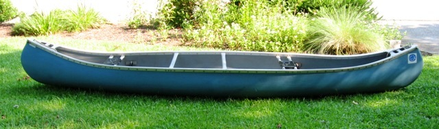

If the boat really was one of the Warsaw Rocket hulls it was 16’. Hard to find a photo now but the appearance would be very similar to this Blue Hole OCA which was a slight modification of the Warsaw Rocket:
http://www.bogley.com/forum/attachment.php?attachmentid=39580&stc=1&d=1291663054
The Blue Hole OCA (and I believe also the Perception Chattooga) have a hull with a flatish bottom, a modest amount of rocker, a bit of tumblehome amidships, and recurved stems as seen in the photo.
