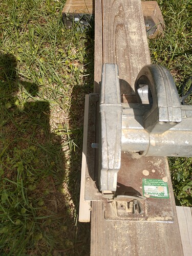

My gunwale cutting jig!
Scored on 20’ cypress planks…
