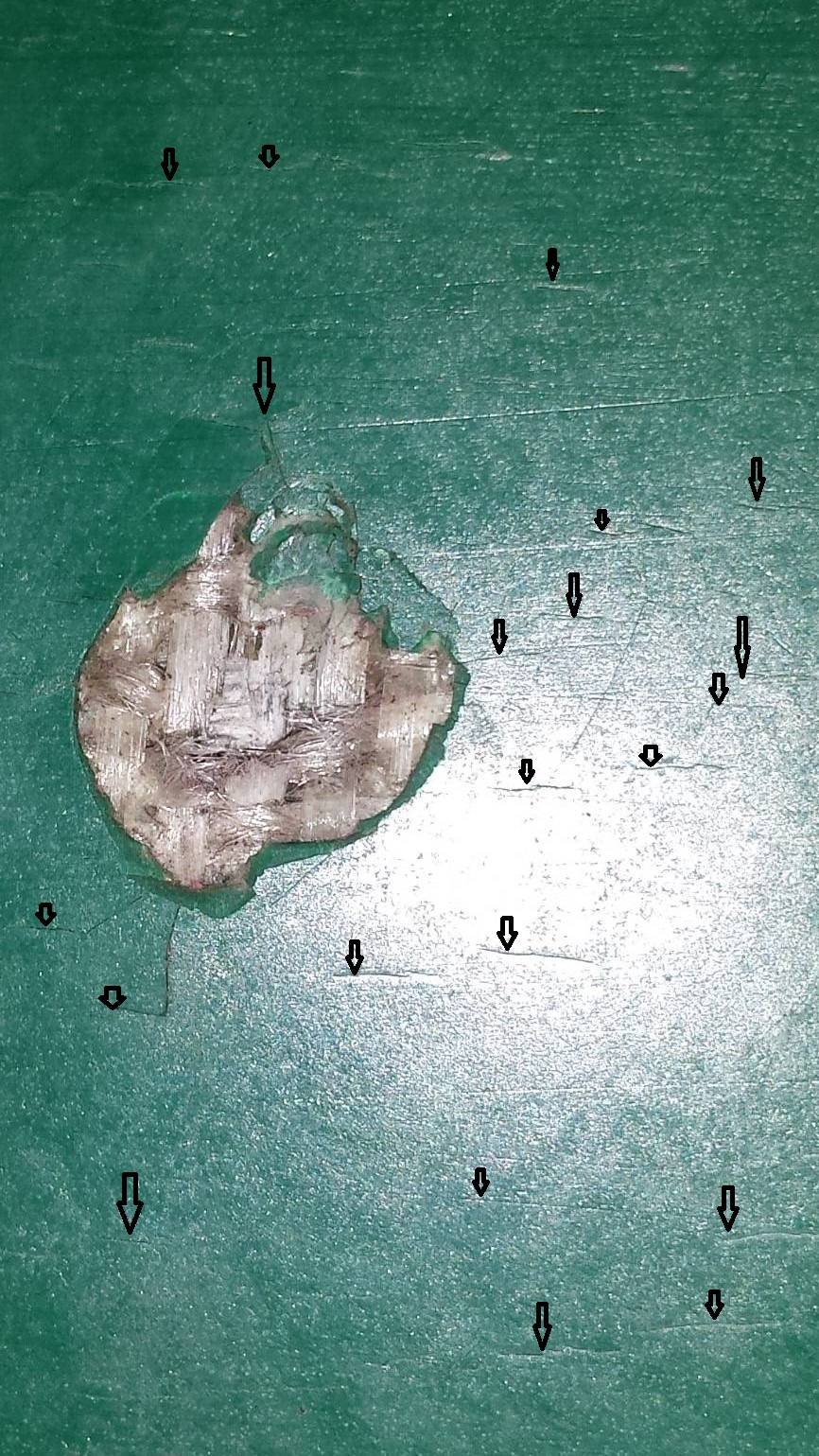

I would whip out my Starbright Cleaner Wax (always have some around) and random orbital buffer and go to the whole boat. They you’ll be able to separate scratches from the cracks. However you have a lot more suspected cracks and seperations than you think. Look at this picture. I have marked all the scratches that look like hairline cracks. Any one of these can weep water and blister a hole by water or impact like your hole in the picture.
If these are cracks you should be able to get an exacto blade in them and pick out a little piece or at least feel the crack. If it were me. I’d likely check for loose chips and prep for painting to seal up all the cracks and prevent water intrusion. Loose will have to be chipped/sanded and patched. Then paint the whole hull.
Scratches aren’t a problem, cracks are.
Yeah I’m still now sure what to make of those things - I think the photo might be making them worse than they look, but I’ll look into it. For now, I’m grinding/sanding out the actual damage, repairing with 5200, and will do a gel-coat repair over top (is this even necessary except for cosmetic?) Also, I’m been hitting it hard with a heavy duty rubbing compound and a lot of this little dimples and creases are working themselves out so far. Thanks for the help!

Oh, right. I’m going to do an epoxy over the 5200. I just wanted the 5200 in first to really grab onto the fibers in the hole. I already drilled it out and filled it with 5200 and it went much better than I had thought it might - wax paper on the interior held in place with duct tape formed a perfect backing for the 5200. I’ve got a nice, shallow divot to fill epoxy with before gelcoating. I’ll update with photos soon.

Yes. But this boat has multiple cracks. I’m guessing it is the result of years of flexing, or some specific impacts. If the gel coat separates from the underlying layers like we see in the “hole” water can enter the crack. Canoes don’t live in the water but they do live upside down outside. Y’all have winter. Water freezing in between laminations can be a bad thing. Without physical examination if it were mine I’d probably just sand down the holes and any chipping cracks and fill with epoxy. Sand smooth and spray can paint a camo pattern. I’d use it as a “beater boat” similar to what we call a Georgia Fishing car or a beater bicycle. Functional without the worry of damaging the “furniture” , a perfect worry free boat…
