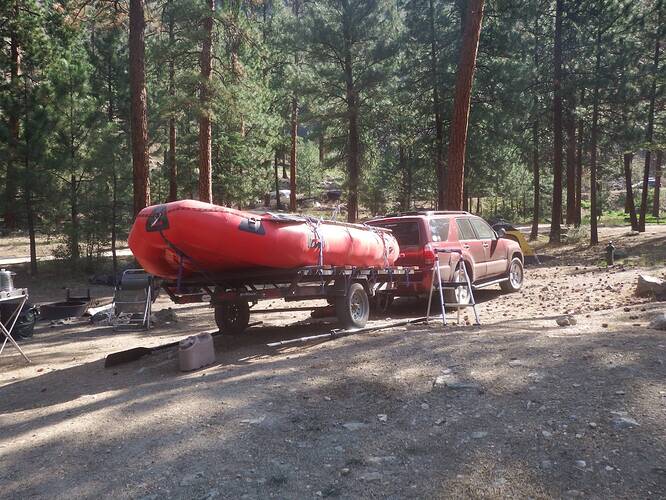

I have a multi-purpose trailer that I use to carry my raft & gear. It began it’s life as a snowmobile trailer with some modifications. Here’s a pic of how it started.
I added stake pockets all around the inner deck, and had 2 foot high metal mesh side panel sections made to enclose the inner deck for gear hauling. There are 6 panels in all (2 per side, 1 front & back). The side panels are easy to put on & take off. I don’t have a picture of the trailer with the side panels on. I added a wood deck with marine carpet over the metal textured deck. When I transport my raft inflated, I leave the side panels off and have 8 cross boards that attach to the flared side rails of the trailer.
My next project will be how to fashion a couple lightweight crossbars that I can attach to the side panels for carrying kayaks & canoes. If I can get the crossbars fairly even with the front & back panels, that would give me 4 points for boats to rest on & be secured to. I’d have my enclosed box for gear and I could carry 2, maybe 3 boats. My biggest issue is that my trailer has a short tongue, so boat length could be a problem. If I had it to do over, I’d get a trailer with a longer tongue.

I don’t know the tongue weight, but the trailer itself weighs about 650 lb. with the sides on, carry capacity is 1460, and the GVWR is 2000. The trailer over all is 9.5 feet long X 6.5 feet wide, so not a large trailer. When I have my raft on it, it’s definitely not centered. More off the back than the front (you can see in the picture), and I do put more weight forward. I load up the front cargo area of the raft with extra weight to prevent too much bouncing & wagging. So far, in about 5 years of having it, it has towed like a dream. An extra 12 inches of space would be nice.
Gear plus a couple kayaks or canoes should be a lot less weight than all my rafting stuff. I’d use it on group trips with 4 people in my SUV, 2 boats on my roof rack, and two boats & gear on the trailer.
