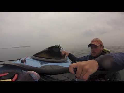

@max3732, watch this video then give it a try. It’s much easier than the technique taught.
Some of the people in our Club have switched to the heel hook method for a self rescue using a paddle float and then a pump. It is faster and requires less upper body strength. Almost all use this method for an assisted rescue now.

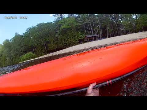

My self-rescue of choice is the re-enter and roll because it is quick, although you pay for that afterwards by having a lot more water to pump out. Here is one from a few days ago:
