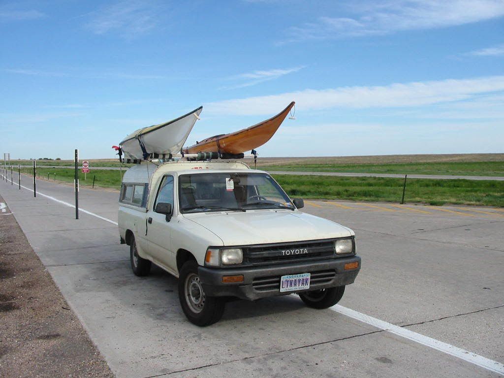

My set up
– Last Updated: Oct-20-07 5:19 PM EST –
http://foldingkayaks.org/gallery/Bahia-de-Los-Angeles-Oct-2007/PA120014
And carrying 2 kayaks at highway speeds about for approx 1500 miles http://i167.photobucket.com/albums/u153/tsunamichuck/100-0070_IMG.jpg
Basically foam blocks on steel bars. Foam blocks work as well on Thule or Yakima.
