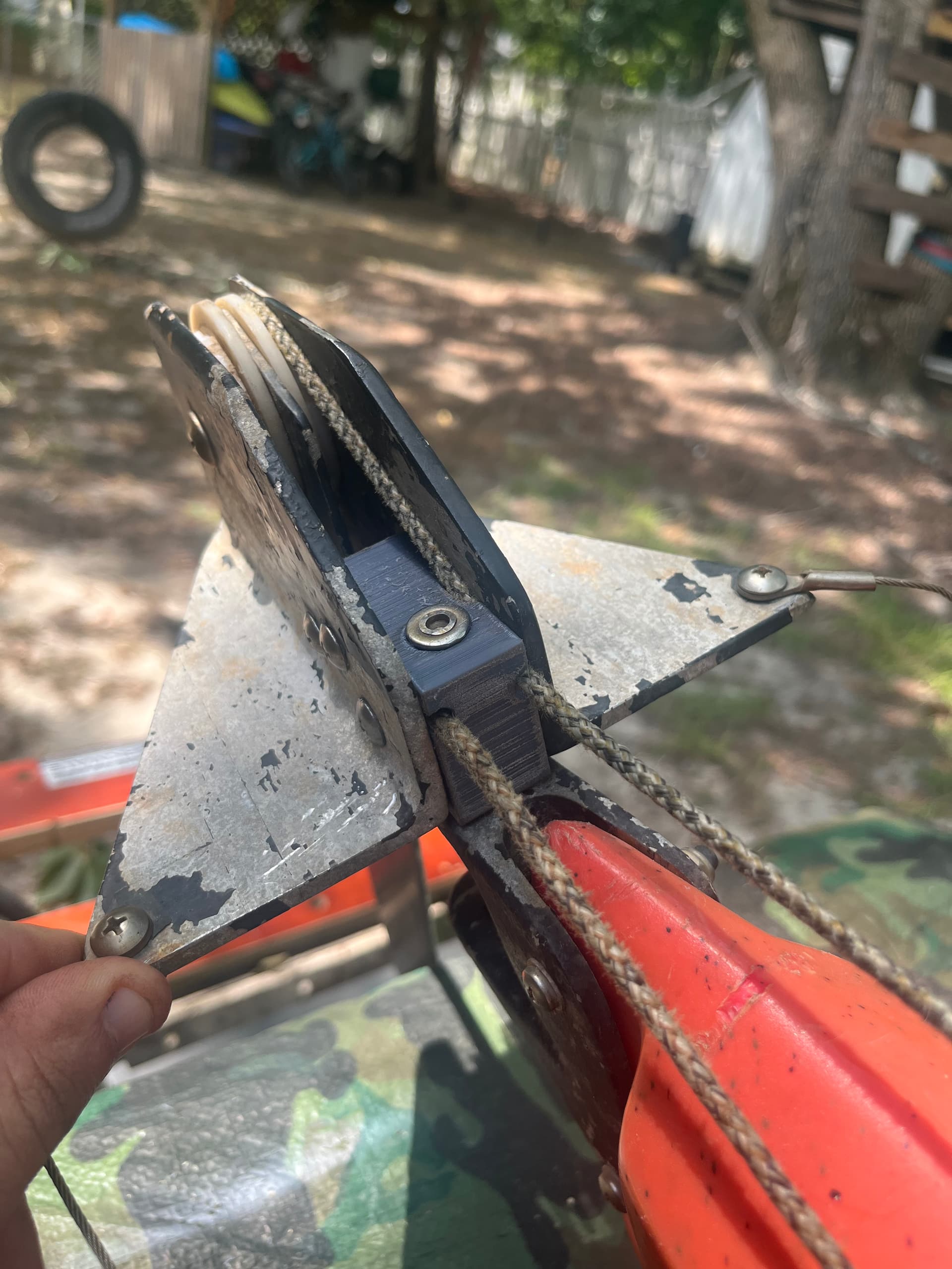

I recently broke A plastic piece on my Chinook NW kayak that mainly allows you to flip the rudder up and down when needed as well as spaces everything correctly… I have found a few posts of people looking for that plastic part.
Well being that I could not find one I had a buddy redesign it and he 3d printed me one
and its working great so far… So if anyone out there is still in need of that part. I can get you the file or have one printed if needed. This uses the Original pin and replaces the block only

I only have the one file for one part. I will share that with anyone but I don’t really feel like hounding my friend to have lots of them made. He is pretty busy and I don’t want to lose the privilege’s I have by making this a nuisance… If I can figure out a way to just post the file up here for anyone I will. I sent the file to a few people maybe one of them is willing to print up a few?
Hi LandofRath,
I think most of us would just love to have the 3D file if you could send it or put on a drive space where we could download it. No need for a printed piece for me–thanks!
See if this link works…
https://drive.google.com/uc?export=download&id=1N9ljWsH-yh9kn1T-yU5S5CwR1PlO_K9x
It looks like that worked! Fantastic-thanks very much!

I used this design and shared it with my friend, he 3D printed it and it fit perfectly! Thanks!
