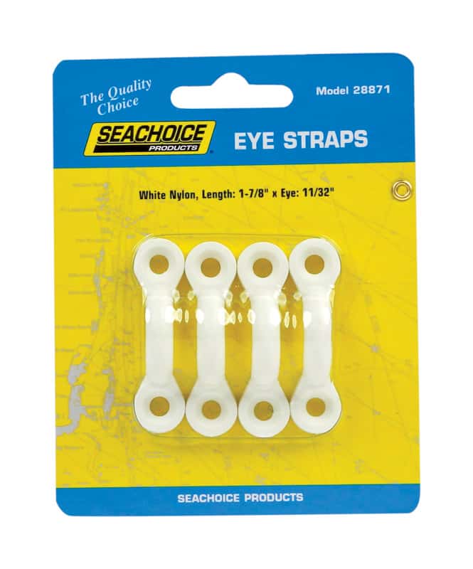

Bungees and a couple of nylon pad eyes which you bolt to back of the bulkhead. That’s how CD does it.
By pad eyes do you mean these? That would makes sense based on the small holes I see, but I wasn’t familiar with that term
Yes similar those are a bit wider.
