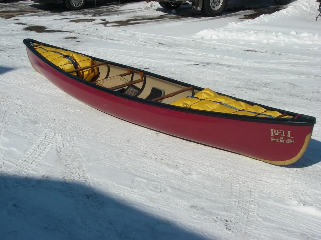

Here is a pic of bag lacing on one (boat on the right)

I bagged my Wildfire

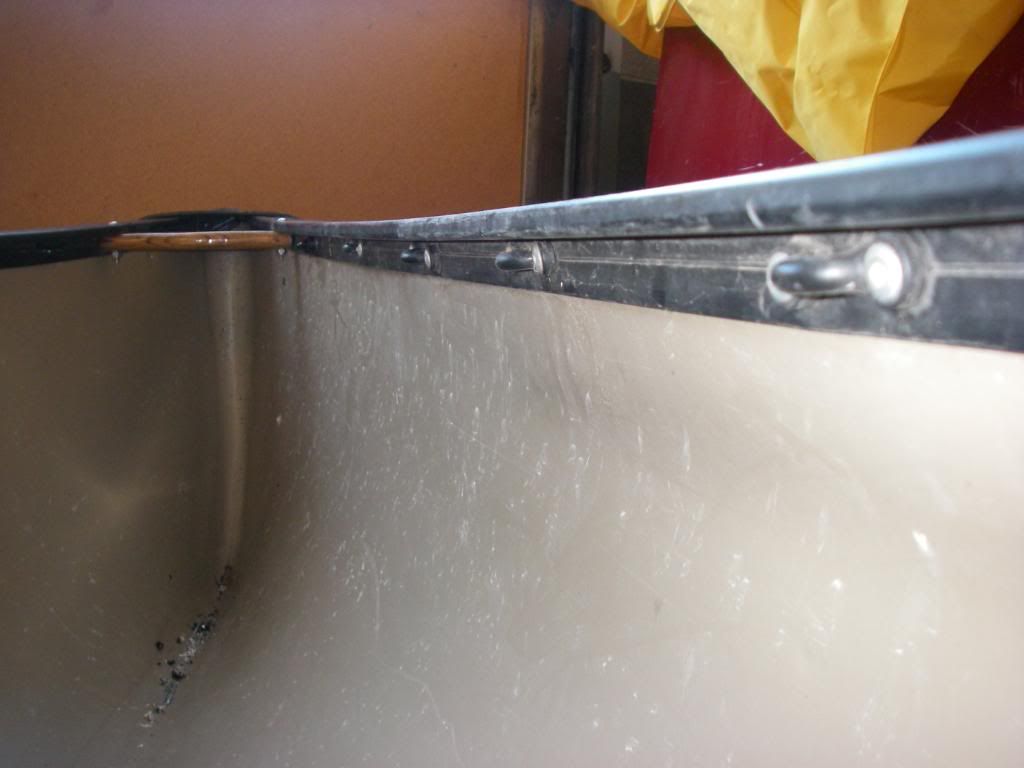

I used padeyes for lacing eyelets. To minimize the number of holes in the hull, I drilled out the rivets holding the gunwales and used that hole as one of the two needed for the padeyes.
(http://i15.photobucket.com/albums/a385/nermalgod/Wildfire%20Outfitting/IMGP8469.jpg)
I’ve changed the bag arrangement a little, but here’s an overview of my first setup.

I imagine you’ve changed your bag
arrangement to get more lace control. Your starting setup looks a bit sparse.
I like your pad eye approach. You can get more lacing coverage with no increase in padeyes, just by adding diagonal to cross lacing.
looks nice
Looks clean.
Dare I point out that you have drilled exactly as many new holes through the hull to secure the pad eyes as you would have done if you had just laced the cord through and run it under the outwales on the outside of the hull.
Your arrangement does make it easier to thread the lacing and eliminates the visible parts of the parachute cord running under the outwales, if you object to that.
pretty much
What I was trying to avoid was a hole to hold the gunwale and two for the padeye. So my way cut down on some holes but not as many as lacing through the hull. I added two more lines running the length of the bag. It isn’t a whitewater boat, so I wasn’t concerned about making it completely bombproof.
