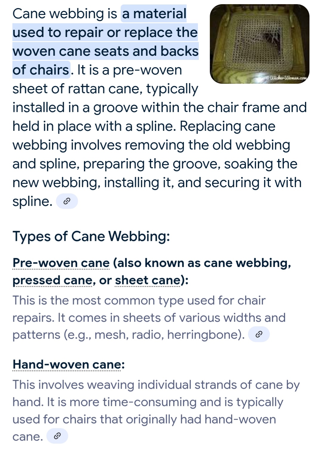

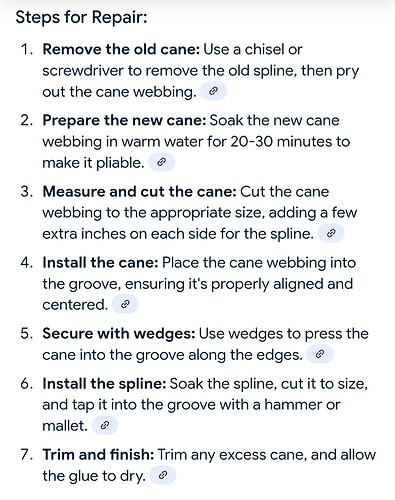

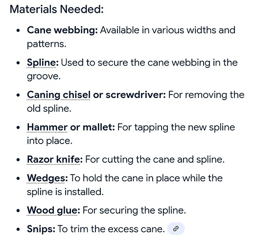

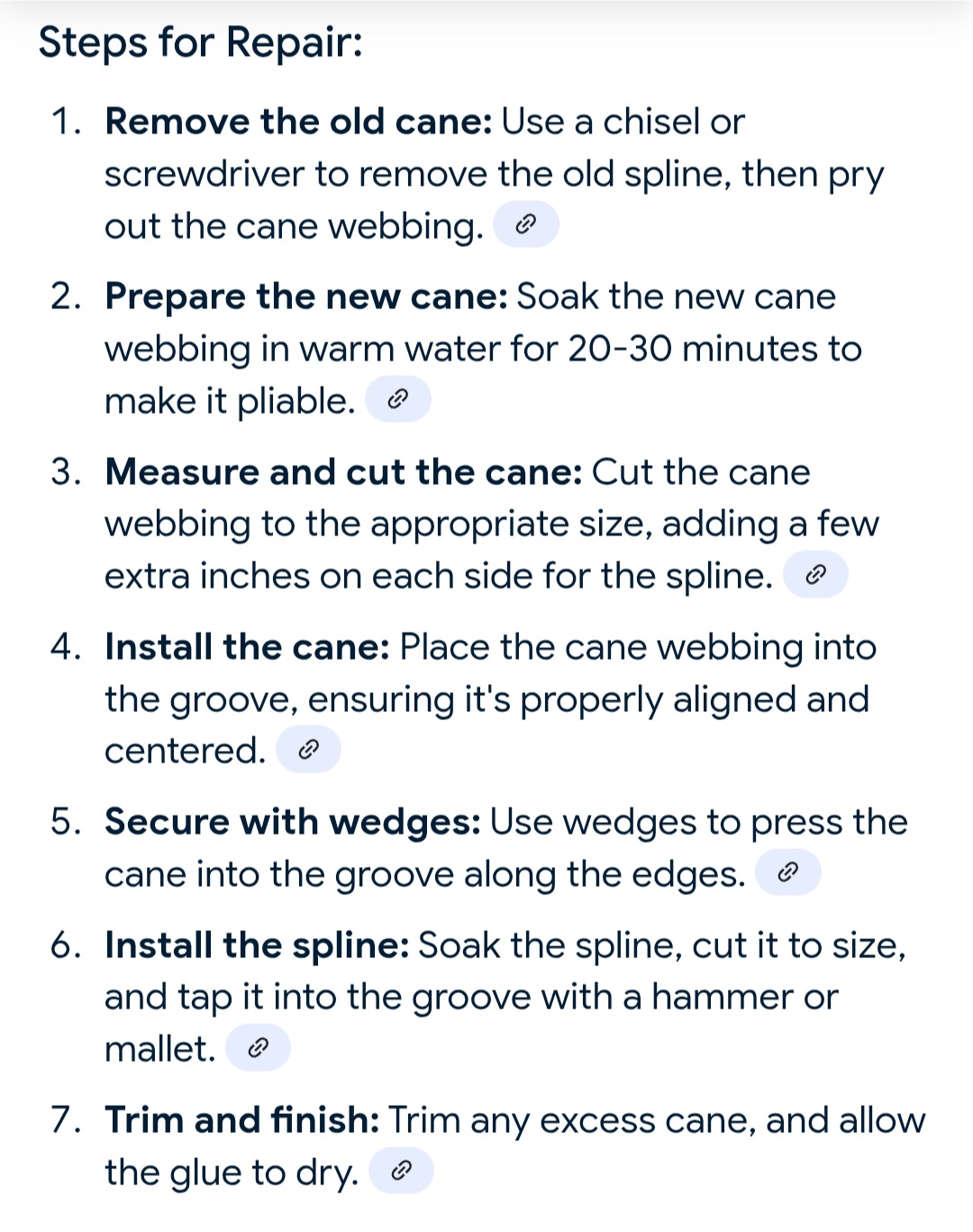

That material is available. You can probably repair it yourself. You’d wet it and press in reed material.
If you use webbing don’t use nylon because it will stretch when wet, but use polypropylene instead.
I did this method but didn’t use cotton clothesline. Rawhide is traditional but a low stretch line works well. An 1/8" line for sailing is good.
$5 Canoe Seat Repair/Snowshoe Weave : 5 Steps (with Pictures) - Instructables
I like that idea, but I did a search for cane webbing source from woodworking stores and found it on the Walmart website.
The key is thorough wetting to make it pliable. A veneer saw can be used to cut it and trim it once installed.
