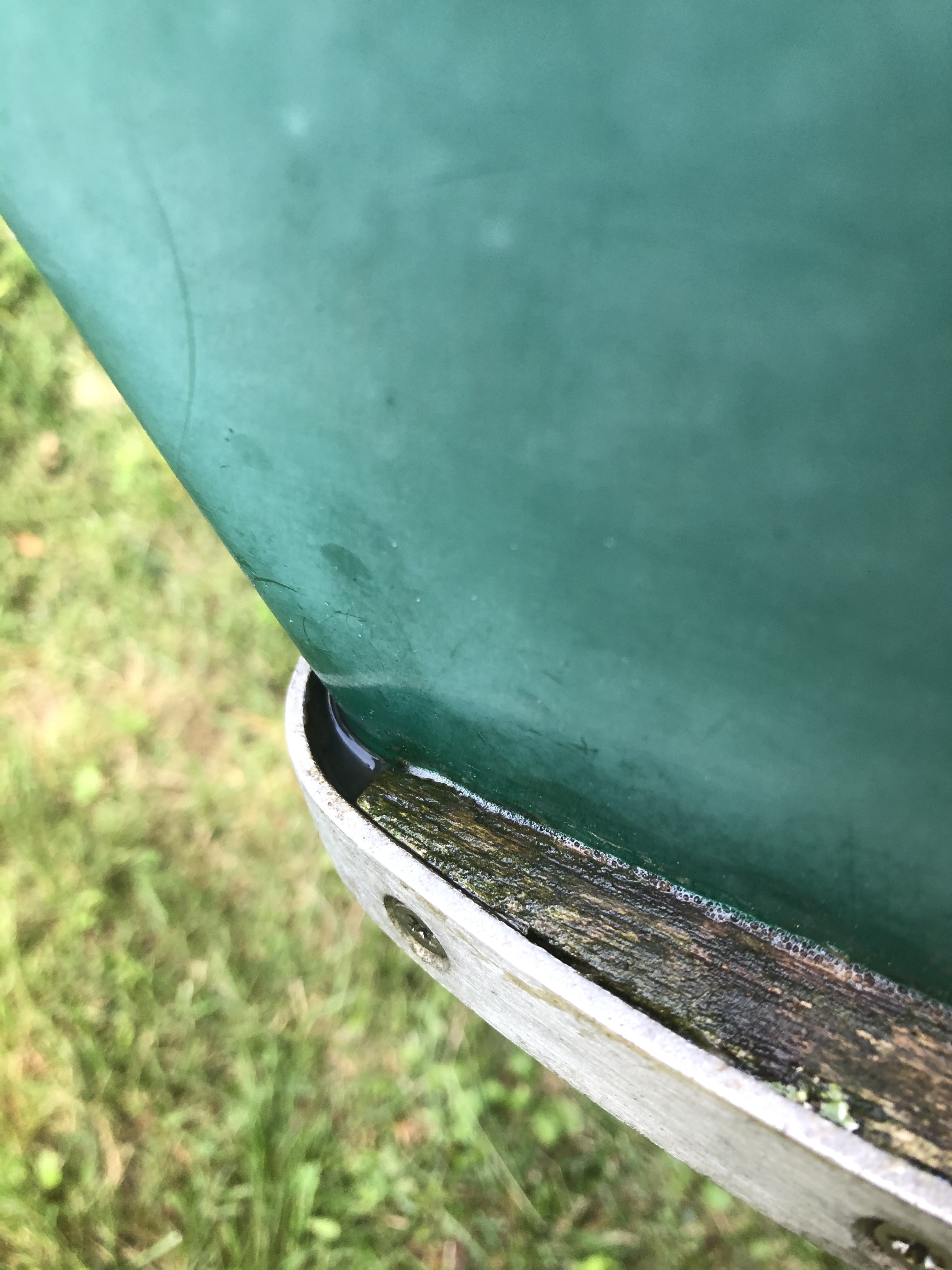

The canoe I’ve just begun rehabbing has metal end caps. There is a lot of decay in the wooden gunwales and deck especially beneath the cap, and when the canoe is stored upside down, water that runs down the underside of the outer gunwales pools in the cap until it evaporates. I’m guessing this is a common issue - would the best bet just be ditching the end caps when I replace the gunwales/decks? Other solutions?

The canoe is the photo is suffering obviously from ground contact. Moisture from the ground has compromised the deck and the gunwales.
I agree with ppine. That was not caused simply by water collecting under the deck plate. But water collecting under the deck plate does occur and can lead to the tip of the inwales and/or deck plate rotting.
I drill a hole right at the tip of the wood trim as close to the hull as I can get to allow the water to drain.
Thanks! The last owner had been keeping it upside down on sawhorses, but I’m not sure for how long. I’m thinking that drilling holes in the tips of the metal plates/caps is worth trying, as that is the lowest point when the boat is upside down and otherwise will lead to more rot. Here’s a pic of the canoe with the plate attached (and full of water)
Metal end deck caps are pretty uncommon. And I have never seen a canoe with inlaid wooden deck plates and deck caps. I suspect the caps were installed to cover up the rot once it had occurred.
It would make absolutely no sense to go to the trouble of trimming and shaping inset deck plates and inwales and then covering them up with an end cap. Plus it would be the worst idea ever as water would be bound to seep between the outwales and the caps when the canoe was upside down and then collect between the gunwales and wooden deck plates and rot them out.
I don’t like end caps/decks for the reasons you’ve discovered and have removed them from the canoes I own(ed). I actually prefer the aesthetics of a canoe without them.
