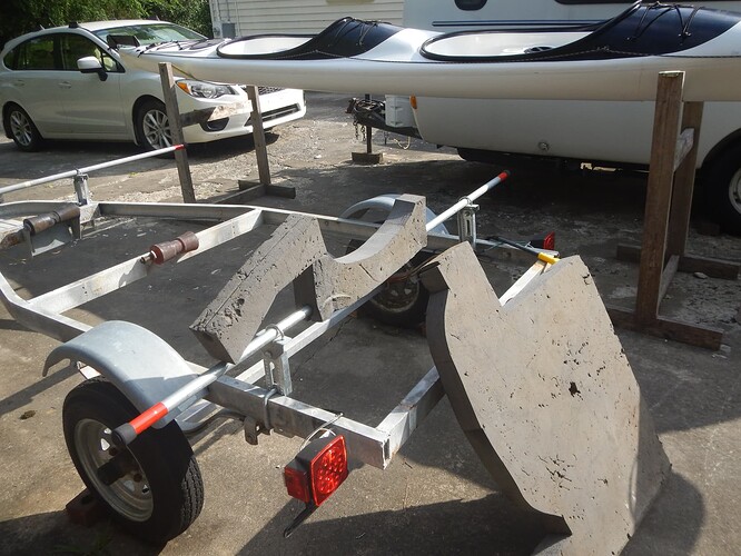

Here’s my boat trailer modification. Can carry three kayaks or two canoes. I carry the canoes upside down and use Minicel blocks to protect the gunnels. The ones I made i9n the photo are for kayaks the big one is custom made for the tandem kayak in the background on the stands.

Looking at the way your trailer is built you could just remove the kayak saddles and bolt a carpet covered 2x4 directly to where the saddles were.
Yes. Remove the kayak cradles. Pad the cross bars.
