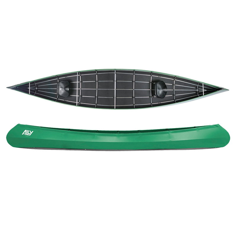

Ally of Norway also makes an 18’ foldable canoe, 47 pounds with the same capacity. Cheaper list price (Pakboat is $2700 and Ally around $2300 US) but shipping from Europe would add to that. Pakboats are usually drop shipped for free from New Hampshire (at least mine all came with free freight.)
