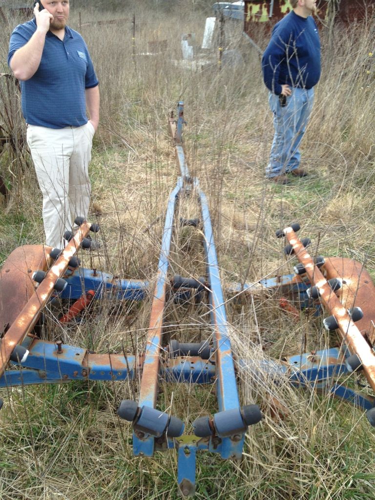

here is the before and after trailer pics. total cost was about $300+ trailer was free from my two friends there but cutting the bend out, painting, used tool boxes, bearings, shocks, new lights and weld work. I did all but the welding and am pleased with it. you can find free trailers like that all day long.

Nice work!
That is SO much better than the average do-it-yourself trailer that gets talked about here. You make a good point about how cheap the starting material for such a nice trailer can be too, which is great since most motorboat trailers are already much better suited to the job than those little kit trailers from places like Harbor Freight or Northern Tool (those trailers are too short for boats, and it’s easier to make a long trailer shorter than to make a short one longer).
My only question would be whether you did anything to soften the ride. I think I would have looked to remove two of the four coil springs or find softer ones. Did you do anything like that? The shock absorbers probably reduce the tendency to bounce though.

that's why I found an old holsclaw trailer as it had hydraulic shocks as well as springs. new shocks cost $30 and empty or loaded the trailer wont jump around. you can see them in orange on the second picture.
this and also here in Indiana if you buy a trailer that is older than a certain year it wont have a title and its very easy to get one. just let them know the possible year and title it as home made and stamp your vin # in that they give you.
