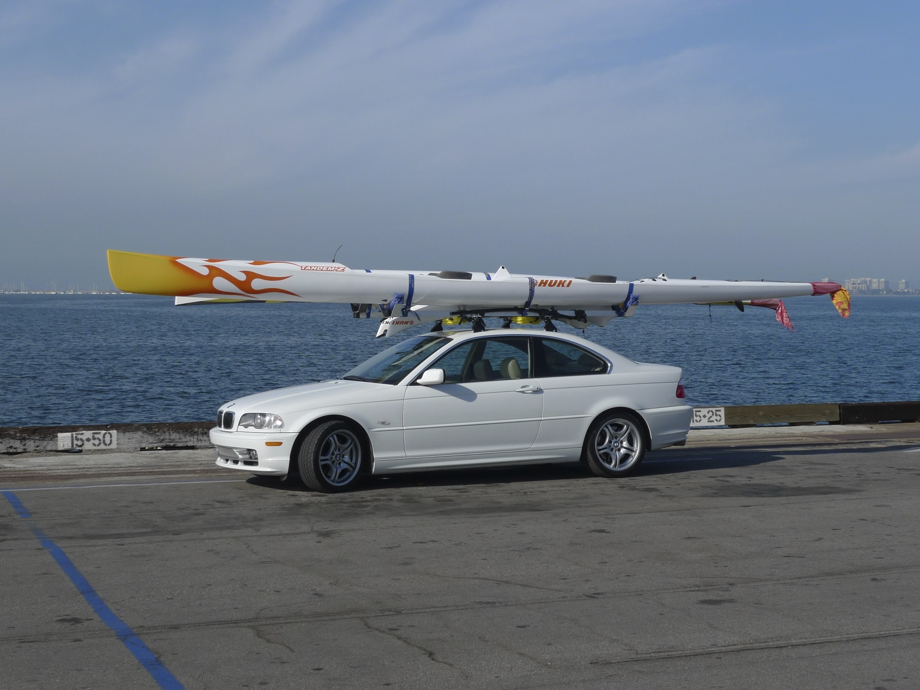

This got me thinking that I don't think I have ever seen end tiedowns at the outrigger events I have attended or at the rowing shell events in my town. So, I looked at what the rowers seem to be using and also found a picture on ocpaddler.com. The answer is that long hull paddlers try to get 6-8 feet between their cartop bars and use racks they trust.
I get 6+ feet between bars on the top of my van. A popular rack extender for small vehicles seems to be the Burnham boat sling:
http://www.burnhamboatslings.com/StoreFront.bok
Here is a picture, which you can magnify, of a Huki outrigger on a compact car using a Burnham:
http://www.ocpaddler.com/files/P1000088_0.jpg

Keep in mind, the picture with the BMW still shows regular rack with very short spread. The kayak is sitting in a very nice cradle, so major stress points are removed from the kayak. Unfortunately, the points were stress/forces are transferred to the car are absolutely the same to what would happen with your run of the mill saddles or what not.
