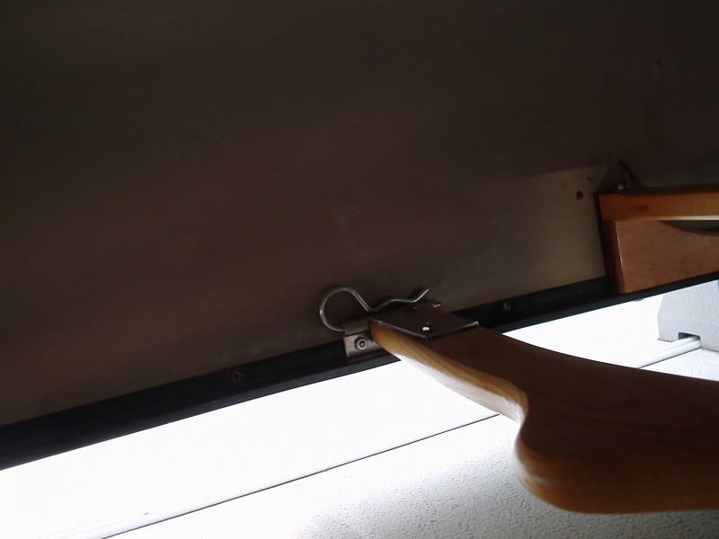

Notice the carrying thwart - it has quick-release clips bolted to the hull. The clips were a special order part, but they really aren’t anything more than aluminum strap hinges with large clip pins instead of hinge pins. The “frame” side of the hinge goes horizontally against the hull under the gun’l with the pin loops down and the strap or “door” side of the hinge bolts to the underside of the thwart. Line up the sides of the hinge and insert pins, and you’re off and carrying. You have to shave a little off the ends of the thwart to accommodate the thickness of the hinge.

Steve, I’d like to know more about your temporary thwart, and what’s this about aluminum hinges? What does that do for a carry thwart?

The "hinge"...
http://i85.photobucket.com/albums/k63/swb9321/BUSH1290.jpg
This photo might be clearer...
http://i85.photobucket.com/albums/k63/swb9321/BUSH1289.jpg

I appreciate the coaching and the pics. Steve, your boat is set up exactly like what I had in mind. I’m going to go without the rear thwart, will put one forward, just far enough to give me leg room. That should also make a nice hand-hold when carrying it. I’ll have to get creative attaching the hinges, my gunnels are square tubing, but I think I can figure a way to make 'em work and stay tucked under gunnel. You mentioned special ordering, what did you need that you couldn’t get at the hardware store?

...could be found in a hardware store, Jim. Or you could order it as a kit...
http://www.rutabaga.com/product.asp?pid=1012348
You can see in the photo that it's really nothing more than just a strap hinge and mounting hardware with clip pins - but it includes instructions.
Doesn't matter what material your gun'l is because you can just drill bolt holes in the hull just below it for one half of the "hinge".

Hoping to find a hinge I can cut down and use existing holes. Would rather not drill hull below gunnel but will if I don’t have room to mount hinge on bottom side. This is my first canoe and already wishing I’d held out ‘til I found a 16’ but this not canoe country and you don’t find many decent used river canoes. Would like to keep mods as clean as i can for resale when the right one does show up!
