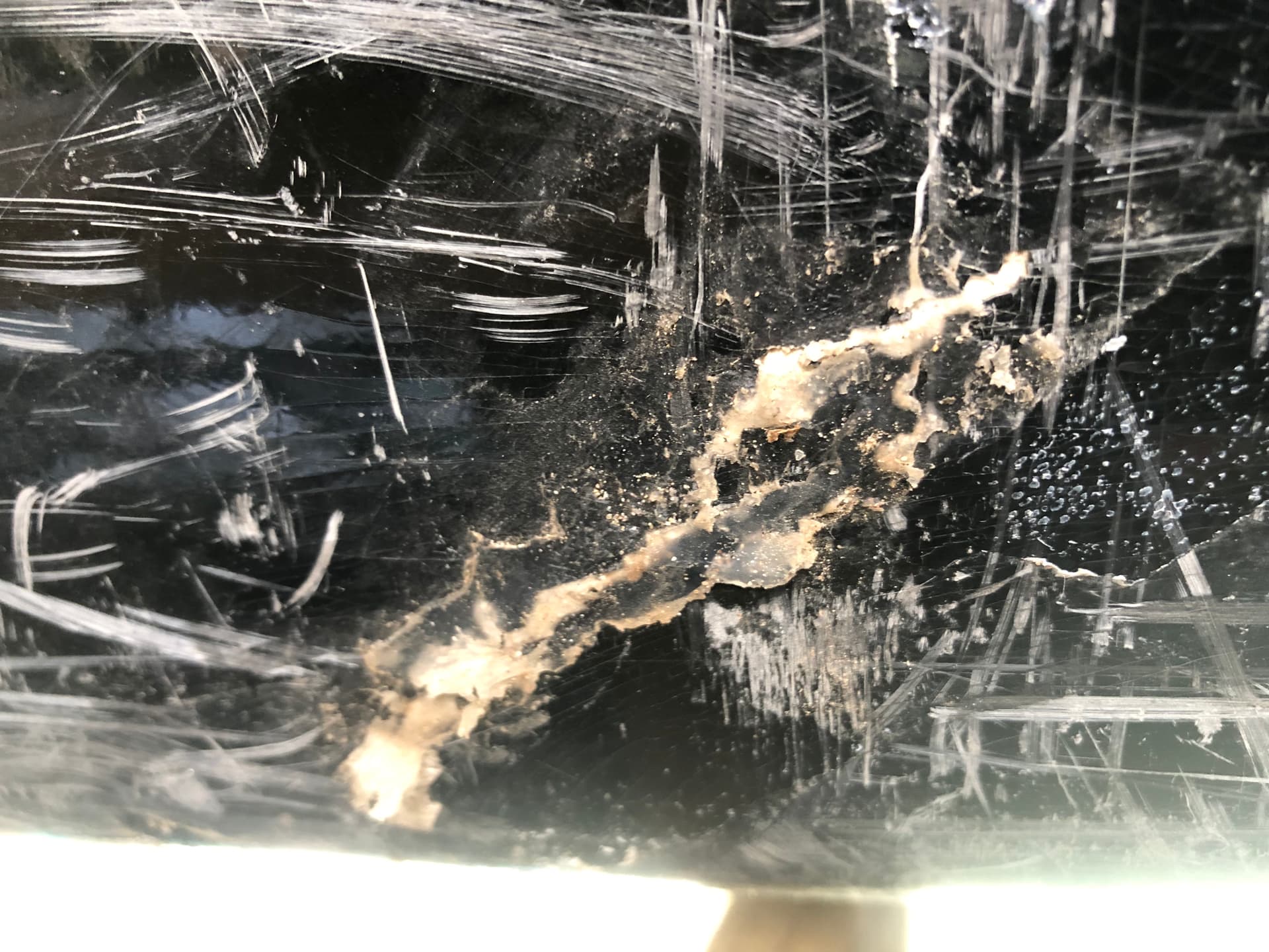

I’m guessing I’ll need to either Dremel or sand (or both) the glue off the crack. I may have made the problem worse, but the quick temporary repair put me back on track to do my trip. (I think the crack was enough that it would have leaked a bit, or at minimum, gotten in to the layers of glass composite).
Hull crack:

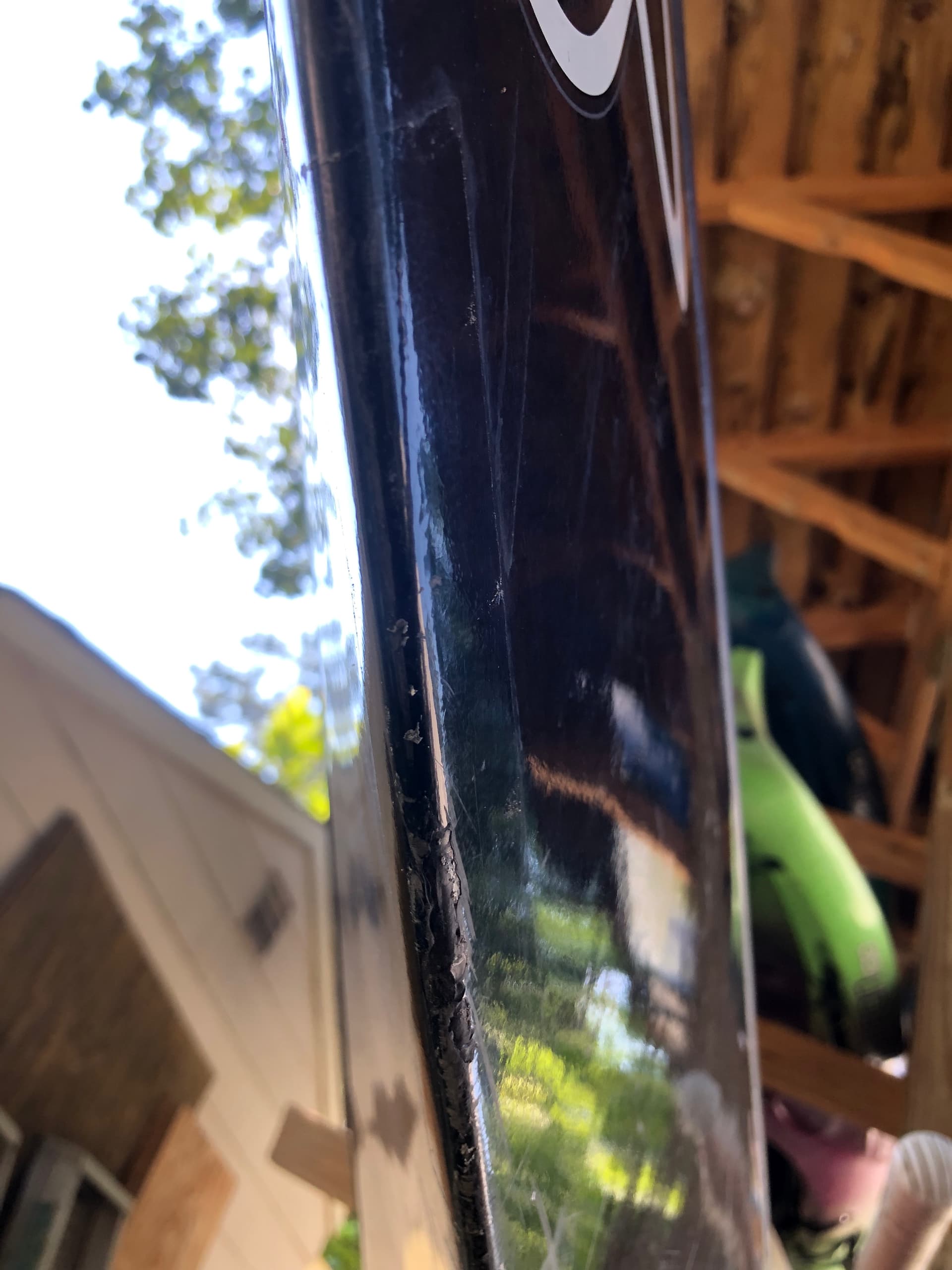

Minor bow damage:

Diolen is a polyester based fiber. Diolen is often used as a somewhat cheaper alternative to aramids like Kevlar. It does not have the tensile strength of Kevlar but has good impact strength and abrasion resistance so it is a good choice for paddle boats.
Diolen is always (to my knowledge) used in conjunction with another type of fabric, usually fiberglass, sometimes aramid.
I don’t know what type of resin was used to construct your boat, polyester, vinyl-ester, or epoxy. But regardless of what it was epoxy will bind to it, as it will to Diolen, aramid, and fiberglass. It is what I would use for repairs.
I can’t really tell how I would go about repairing the boat without seeing it. You will need to remove the marine glue you used to ensure a good bond to the structural fabric. If you can access the areas of damage from the interior of the kayak, I would do most of the repairs internally. Cracks usually need to be guttered out to increase the bonding surface for your epoxy, then filled. For filling cracks it is best to moderately thicken the mixed epoxy with something like silica power. Applying a patch of one or more layers internally, if possible, may then be sufficient to back up the repair.
I have used epoxies from multiple different manufacturers but West System’s products have long been my favorite. I would use their 105 resin. Unless you are forced to work in very cold ambient temperatures, I would recommend their 205 “slow” hardener to increase your working time and pot life.

Patch inside of hull first to retain the shape. Then move to the outside and cut and grind what you need to get to undamaged glass. West Systems is great. So many scratches will never be repaired unless you shoot gelcoat on deck. Easier to paint with Interlux paint. Two part is very tough stuff. I did one Extreme with it 12 years ago. It faded if you look below deck lines slightly. It all remains very shiny. Great stuff :blush:
