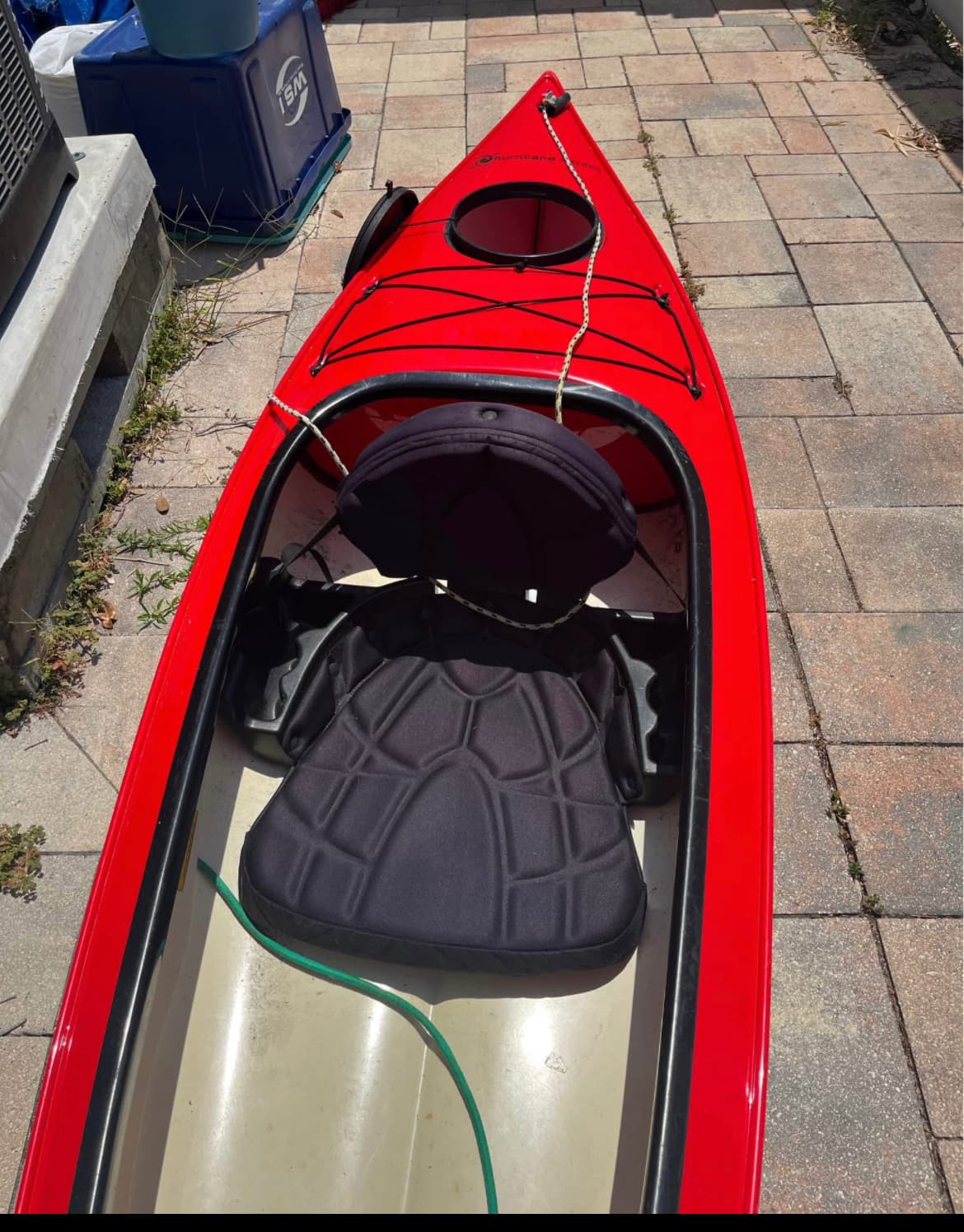

Afternoon,
Santee 11’6 Kayak about 4 hours round trip from me… $50.00. Is it worth the price for these cracks… are they easily repairable and safe for Florida rivers? If so, what would it cost to repair and what is the recommended method that fix? Quality kayak brand model and overall?

That is a severe crack. My impulse is to scrap the boat but for $50 it might be worth a try if you have the time. Looks like a high probability of failure.
If it is cracked on both sides, don’t waste your time and money.
2 cracks in the boat not just one… forgot to mention that
Thank you… saved me time and money
I’d get another opinion from someone familiar with plastic repair. Was it run over?
No idea … only know what I posted… haven’t contacted seller… thought perhaps I’d ask here first to see if even worth potential investment repair as a 2nd quality kayak for good price
You can use Gator Patch to do a patch on the inside, though I’m not sure they make one big enough for that split. We’d put another patch on the outside using G-flex and fiberglass tape. For $50, and $250 in materials, you can likely make it water tight.
But Hurricanes are a little known for being easily broken, so only invest if you know you can protect the boat from hitting submerged objects.
Is it worth the uncertainty and lack of confidence in a boat that you are compelled to depend on. Do you want to contemplate the possibility that the repairs may fail with every padfle stroke, and who will you arrange on a retainer to rescue you from the $50 gamble. Another way to look at it: Would you consider the challenge if you saw the boat at the curb on garbage days. I can’t imagine the $50 price tag makes it a more desireable deal.
We seem to have a quorum; keep looking and good luck.
from the pictures the one crack appears to be running toward the bottom of the boat and the other is close enough to the bottom to severely compromise the integrity of the boat.
Long and the short is that that boat is done. and should only be used as a flower planter. at this juncture.
Unless you intend to glass the entire hull, bow to stern and wrap onto the deck I’d consider it a lost cause.
That’s about the only way to repair that and also be structurally sound
Others have have made the same observation elsewhere on this site, especially w/ regard to older boats.
Hurricane’s are made of ABS plastic which is very difficult to repair. Little sticks to ABS and the preferred repair method is thermal plastic welding which can be tricky and requires a fair amount of skill. ABS is known for being brittle, especially when cold. Thermaform boats are generally a sandwich of polyethylene, polypropylene, and ABS fused together with heat and pressure. They would be much stronger than ABS alone.
Hurricane emphasizes its’ light weight. Apparently they went a bit too far and ended up with a thin fragile hull. I’ve never seen damage like this. It looks like someone jumped into the cockpit with both feet while it was on soft ground on a cold day.
I would pass on this. A fragile boat to begin with and very difficult to repair.
