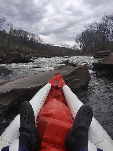

First pic is me in my old Sea Eagle 380x. Third photo is my paddle partner, in his yum-yum yellow Star inflatable(I am in the red+white Thrillseeker.) We been running ledgey Class III & IV ww in all kinds of duckies for the last 15;years.
