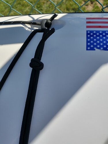

I can loosen bungee by sliding the line.

If you want more friction when using barrel fisherman’s knot to adjust make a triple or even a quad barrel knot.
