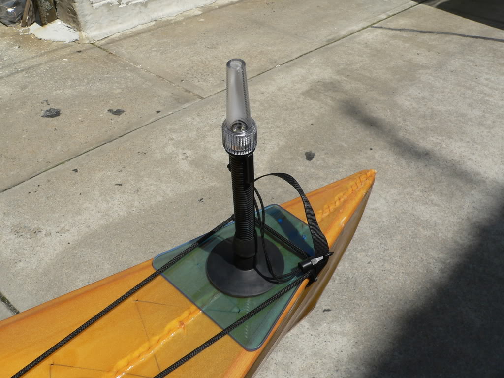

I have that deck light and wanted to mount it on a skin boat, which a suction cup won’t stick to. I removed the suction cup and attached a simple plexi plate that fits under the deck rigging at the stern. It was not hard to do, but I don’t remember the details - I’ll look for it and post some pictures - you may be able to make that work for your boat. What boat are you using?

OK, here’s the original idea - a plexi plate cut to fit under the deck lines on the skin boat. Unfortunately, As PaddleDog mentioned, the suction cup wouldn’t stay attached to the very flat plexi plate, the fix is shown in the next post.
The suction cup is attached to the base of the light with a 1/4-20 truss head screw. I glued an extra plexi block with a threaded hole to accept the screw, overall it works fine.
The blue plate is 3/16", the clear block is 11/16" (both scrap), but the stern of the SOF is flat which is why it works. If you can come up with something to fit on your stern somewhere, provide a threaded hole and attach it to the deck lines, it may work for you.
