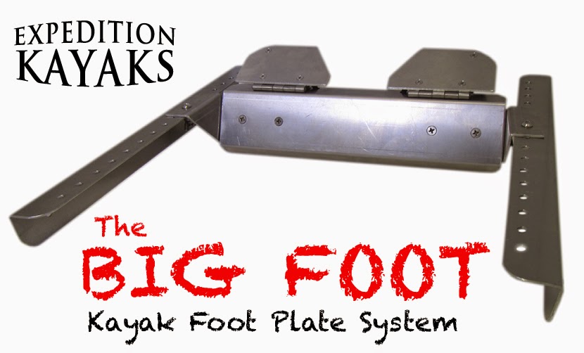

ONNO used to offer a foot-plate conversion – it was made of carbon, very light but didn’t include hardware for angling the plate. I have replaced the small stock pedals with a Big Foot system on my Valley Rapier with very good results (comfortable and allows adjustment of rudder lines from the cockpit), although it is a bit heavier than I prefer. There’s also a version available for kayaks without rudders.
