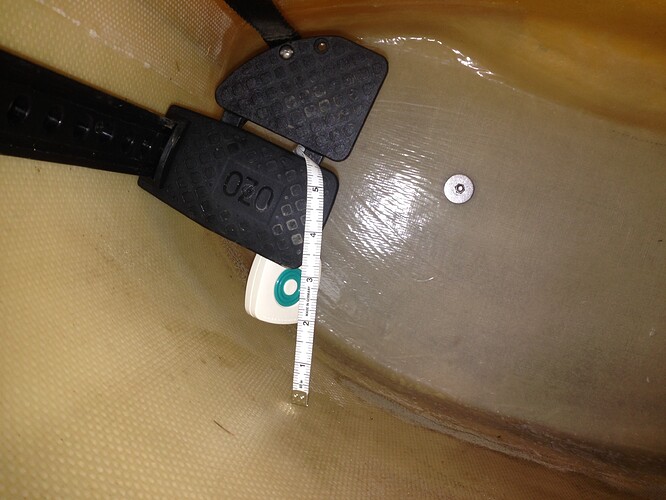

We have a North Shore Atlantic-II double. The foot-pegs in the rear cockpit are closer to the bottom of the hull than are the foot-pegs in the front cockpit. The position of the rear-cockpit foot-pegs (from the hull [vertically]) work well for me. The front-cockpit foot-pegs are too high (vertically) from the hull for my wife to be able to place her toes (let alone the balls of her feet on the pegs\pedals).
Our apparent options are:
  1. Move the peg guide rails down about 2” closer to the bottom of the hull. Downside; drilling new holes in the hull and plugging the existing holes. Upside; the forces on the pegs and guide rails will be similar to what they were designed to be.
  2. Gluing foam onto the inside bottom of the hull to raise her feet such that the balls of her feet rest on the pegs. Downside; The hull below the pegs is pretty vertical (the upper part of a generous radius) so the added foam results in the place where her heels will rest moving inward more than moving upwards. Feet moving into position might tend to peel off the foam (and possibly complicate wet exits). Upside; No real alterations required.

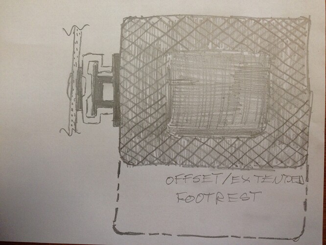

  3. Obtain foot-pegs that extend down (toward the bottom of the hull) lower than the current foot pegs (see attached sketch]. Downside; The forces on the foot-peg guide rail would induce some torque into the peg-rail connection that is not in the original design. These might have to be custom-fabricated if not commercially available. Upside; No holes need added to the hull and the existing guide-rail holes would not need plugged/sealed.
  4. Drill (4-5) holes in the existing foot pegs and attach a rest plate that extends the required distance below the existing foot rest.Upside; Seemingly easy alteration. If existing pegs get compromised they can be replaced - since they are an OEM item. Downside; Seems like it could be rickety and more prone to failure than some of the other options.
  5. Remove the existing foot-pegs (leaving the guide rails in-place) and glue in either one large block (or two smaller individual blocks) that get glued to the bottom of the hull and to the bow hatch bulkhead wall. Upside; Should be easy to try. Downside; cockpit probably won’t fit other paddlers (although we don’t foresee other paddlers needing to use that cockpit).

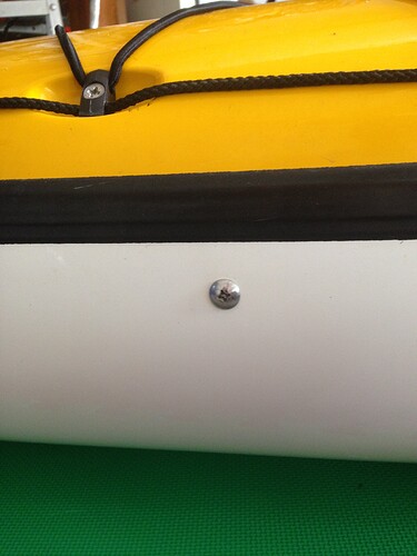

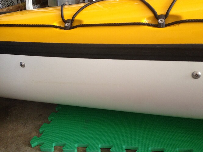

Thanks for that data-point. You said that you drilled new holes for the change. How did you seal the original holes?
The new footpeg track came with its own bolts, so I sealed the older holes with the existing older bolts. I may have capped the bolt ends so they wouldn’t scratch the paddler, but they weren’t an obstruction anyway. They do not leak.
Thanks. Since we’re not adding new tracks we’d just have to get an extra set of bolts to seal the four extra Holes.

You could just put a bolt/screw in the hole with sealant.
PS…second vote for that.

My second choice would be extending the footpegs down, either by adding plates, of finding replacement foot rests. That would also be easy to prototype, and you could jury rig a temporary solution, then go for the final solution. And, that avoids the possibility that moving the rails down adds a change in angle of the foot rests that is suboptimal.
