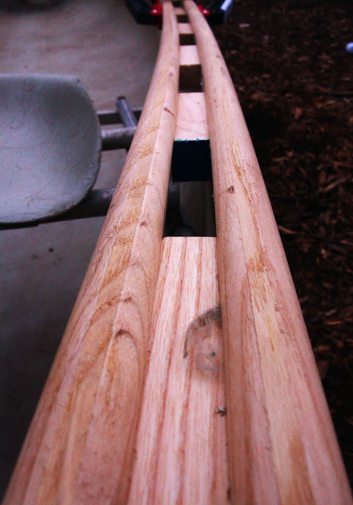

Home made ash gunwales on a Jensen 18…
I managed to do the same job to our (UK built) Jensen 18 without the aid of my wife :banghead:
A single 16’ plank of ash was enough for me to produce the following:
http://lh4.ggpht.com/_myBUfIlhcIU/S8IwNHFd15I/AAAAAAAACAo/5LYY5T15O2Y/s720/gunwale%201.jpg
That’s prior to attaching, let alone to sanding and oiling… but they’ve gone on a treat and the Jensen is now WAY stiffer than before.
