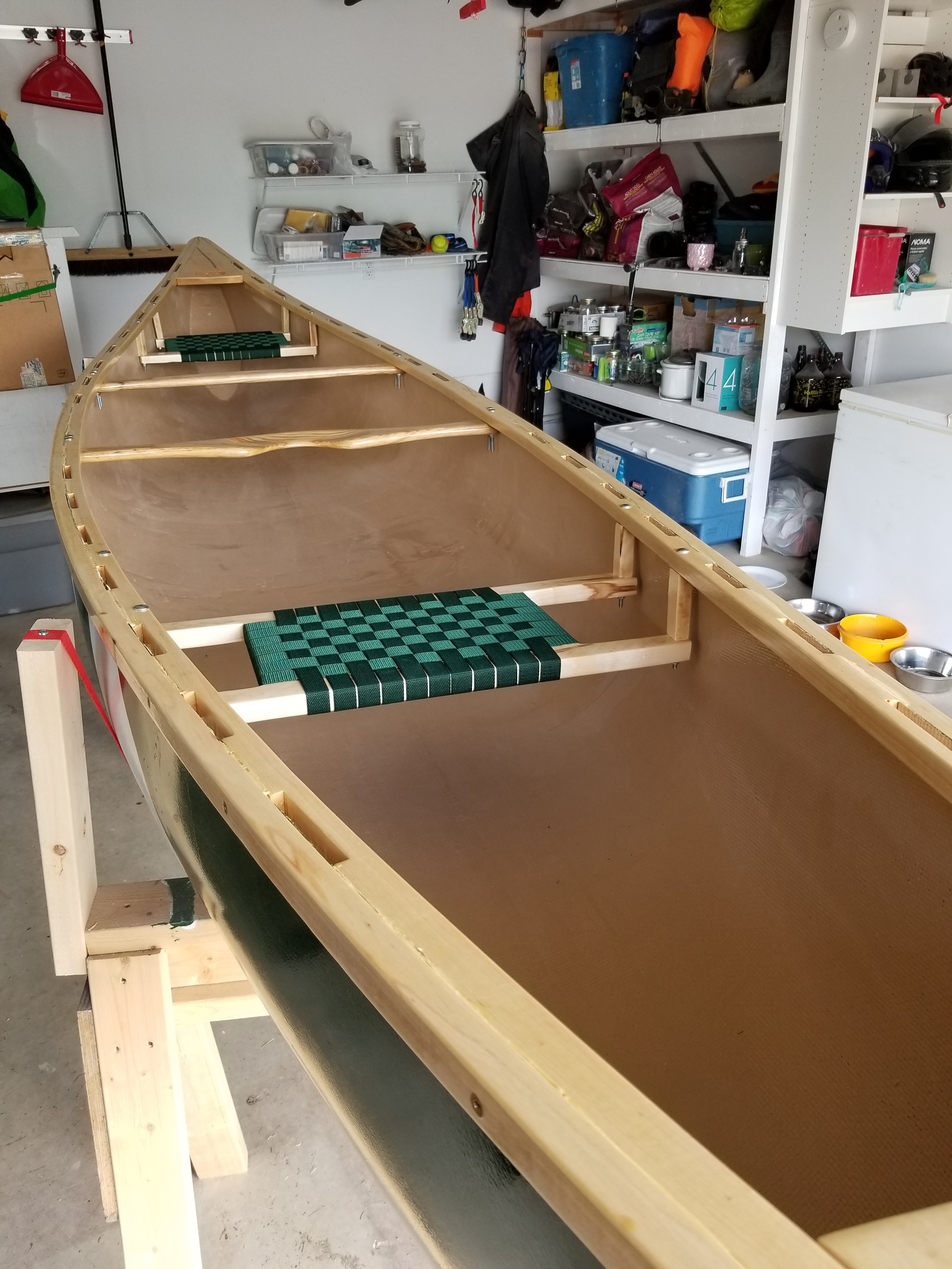

Thanks, I got them on, and for my first time, I am quite pleased.
I tried the trick of just letting them hang with some light weights on them to get a curve. It worked alright.
Looks great!
