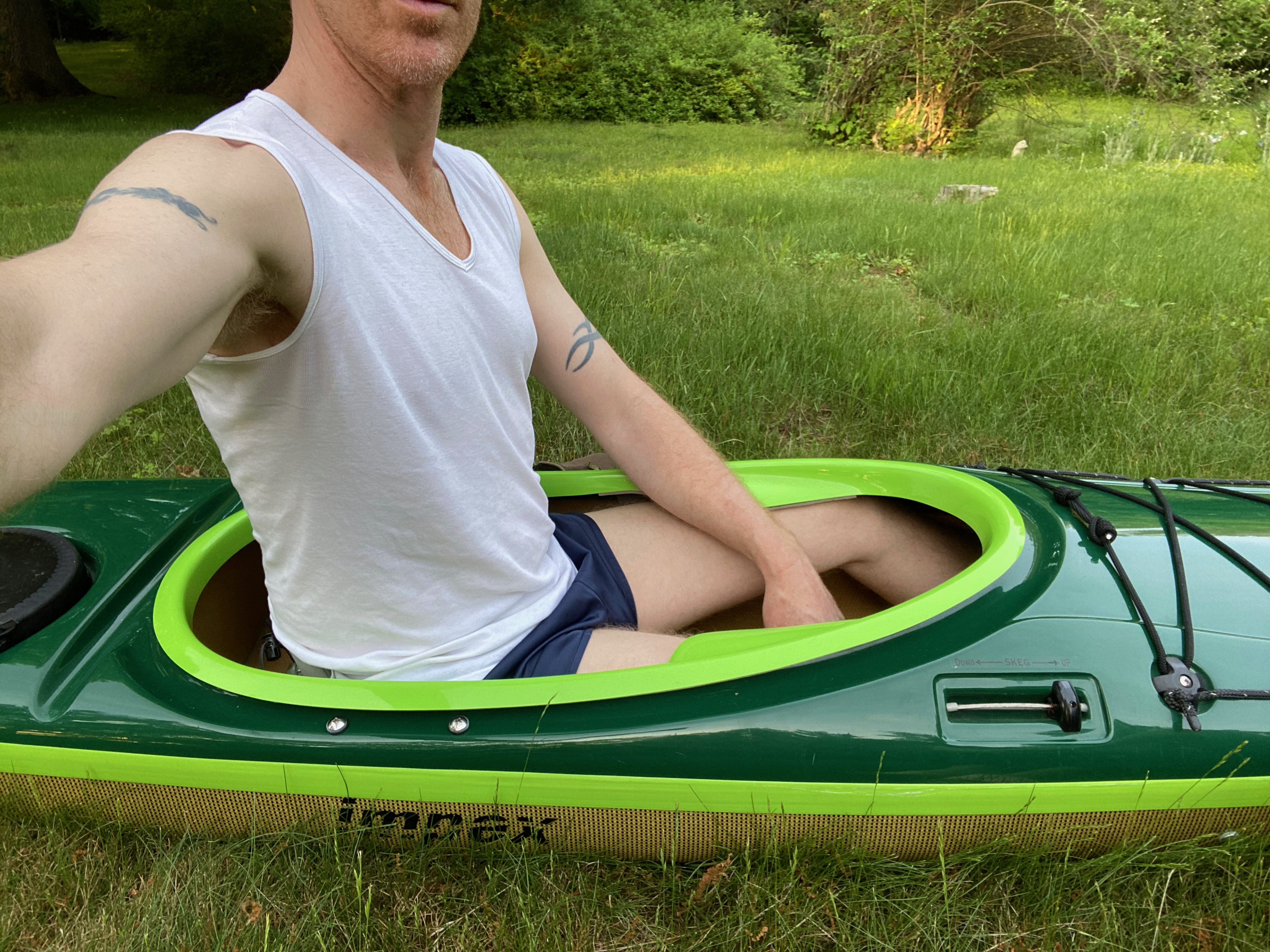

Post some pictures of seat and deck height. Post some pictures of you legs in it.

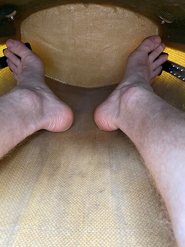

Also, in response to PaddleDog52, I am posting some photos that may or may not be helpful (even after a few minutes of sitting in the boat taking these photos, my hip flexors began to ache and all through dinner my back was hurting)…the last one is of the seat taken out…maybe I just need to ditch that and put a flat piece of minicell on the floor of the cockpit? Oh, and the deck height is 10"…

This is legs bent and feet on the last notch (my heels hurt a bit as well here):
This is my legs outstretched and not yet touching the bulkhead:
Me sitting in the kayak, feeling like I’m falling backwards, so I’m using my thighs to keep myself upright (and it hurts):

Looks like your foot pegs are too far forward as your feet/ankles appear hyper-extended. It may just be the photo angle, but that is the only issue I see.
Suggest you bring the foot pegs closer too you and sit up straighter with whichever seat you choose to use = slide your butt back in the seat. Slouching results in an easier opportunity to get off balance and flip/swim.
I see a couple of things looking at these photos. One is that your feet and the underside of the kayak are a much closer fit than mine. Strongly suggest foaming out the bulkhead so that you have more flexibility in your foot position. Also add some thing foam to under where your feet go. Bulkhead is plenty strong.
I also think the supposed ergonomic seat has you tilting back a bit, so that over a longer haul your thighs are going to be taking on a lot of work. Problem with taking it out is that it appears the backband is anchored to the seat pan, so you would not have any anchor points for the bacband if you switched seats.
Filling in the rear portion so the profile is flatter may be your only shot. If that helps you will have enough info to know if you want to cut away support under the front of the seat if that is possible.
I strongly disagree with locking yourself in there too tight. As long as you can reach your anchor points in a pinch you are fine. If you were racing you would need to be in perfect position all the time, but no indication you are doing that.
You say you feel like you have to fight falling backward, so your thighs compensate. Likely your back muscles as well. I would think carefully about how to set things up so that you can relax and not fight falling backward. Then try some prototyping to see if it works. Can be temporary, simple, just shoving some padding here or there. Keep trying things until you find what works. that should lead you to a solution that you can try on the water, then hopefully a final solution.
