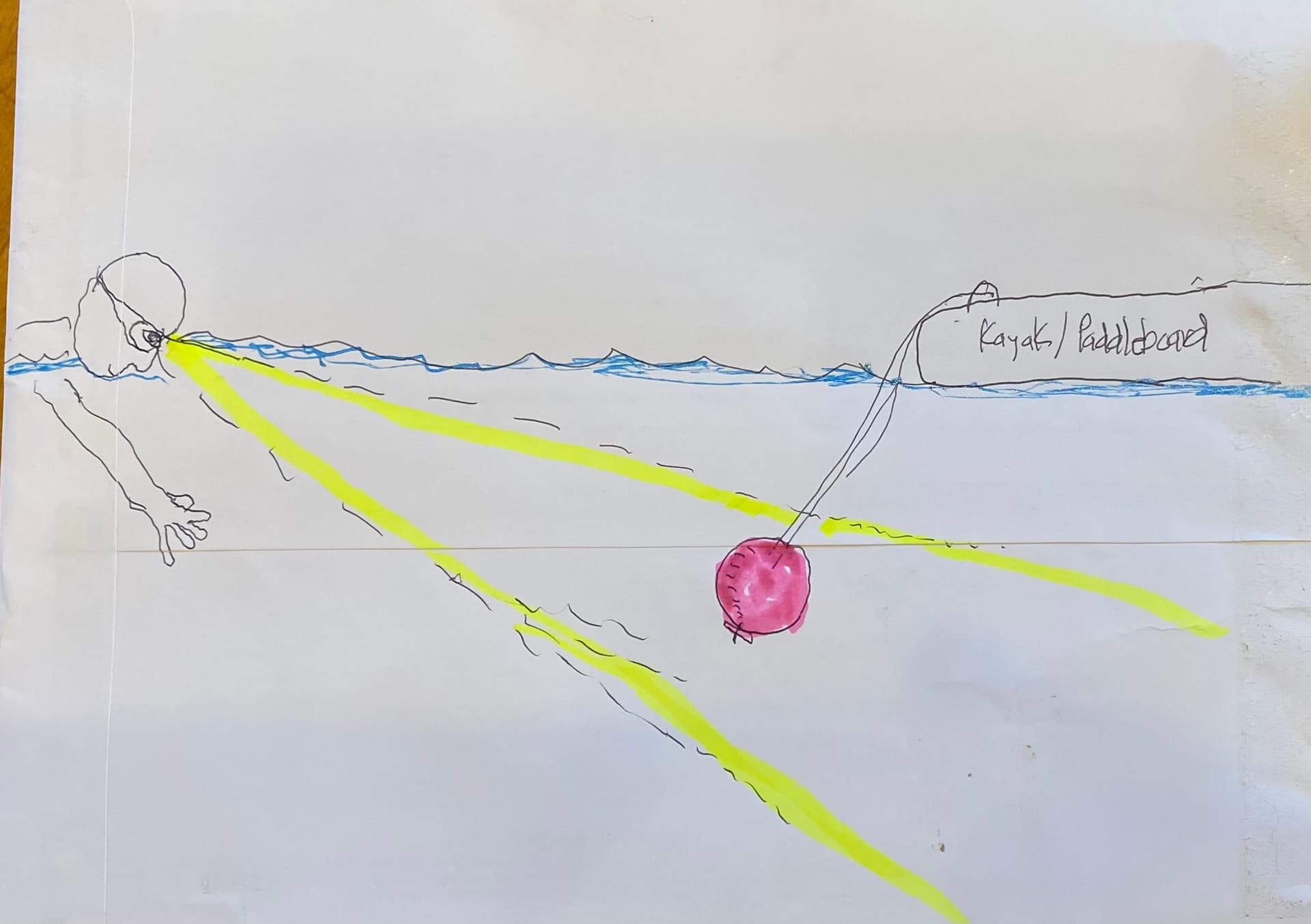

This is the perfect crew to ask this: I need help designing an underwater ball I can tow behind a kayak or SUP or canoe. My wife needs to swim with a snorkel because of neck mobility issues, but she is like a barracuda when she gets going! In the summer, my son and I go to local ponds and lakes for him to train for triathlons: there are submerged trees and branches and rocks and I guide him away from them. But with my wife, she could not see me at all, even if I paddled right beside her.
her field of vision is somewhere between 90 degrees straight down, and about 30 to 45 degrees down from the surface.
But she asked if I could tow a “ball” behind the canoe, one that would sink, but not be too heavy.
Any ideas from the think tank? I’m going out to test things today like a bottle of water, or with some pennies in it. I wonder if there is some material that is just a little denser than water that could be about dodge-ball size?
