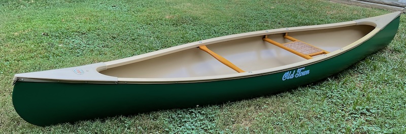

TL;DR: I used Cascade Complete brand automatic dishwasher detergent. Watch out for methyl alcohol in denatured or similar solvents- it is dangerous!
I have a Pack 12 that I bought new around 1984. About 20 years ago I removed the stickiness using denatured alcohol and lots of rags (and lots of elbow grease!) as recommended at the time by Old Town. The MSDS for that denatured alcohol was almost entirely ethyl alcohol with just a bit of methyl alcohol to denature it (render it unsafe to drink). The second time I removed the stickiness, June 2025, I needed more denatured alcohol but the MSDSs for the locally available stuff showed it was almost entirely methyl alcohol. Methyl alcohol is very unhealthy relative to ethyl acohol- both to breathe vapors and it’s absorbed through skin! Also it’s more flammable than ethyl alcohol. FWIW both burn with an invisible flame. So…
I made a strong solution of Cascade Complete brand automatic dishwasher detergent and scrubbed a quarter of inside surface of the canoe while wearing gloves then rinsed the entire inner surface well with a pressure washer but a garden hose would have worked. I had the canoe leaning on a tree limb at a 45 deg angle to allow drainage. Repeated for rest of inside surface then did outside surface in same manner but sans tree limb. Let dry throughly then treated with 303 Protectant to bring back gloss. Came out well:
The cleaning didn’t appear to damage the exposed, outer PVC plastic but time will tell.
