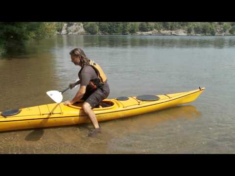

Sit on the back deck, stick your legs in, slide your butt in. Paddle under/behind you as a brace.

My method was to plant the paddle one end on shore or shallows and the other end on the far side of the boat, shaft right behind the cockpit. Stand next to the boat facing forward at the cockpit, grab the cockpit edge at back center and the paddle shaft in the same grip with one hand. Grab the shaft on the other side of you toward shore with the other. Put all you weight on the shaft and slide in feet first. Pretty much like at 1:56 in this video: https://www.youtube.com/watch?v=LOaSwKGExOc
