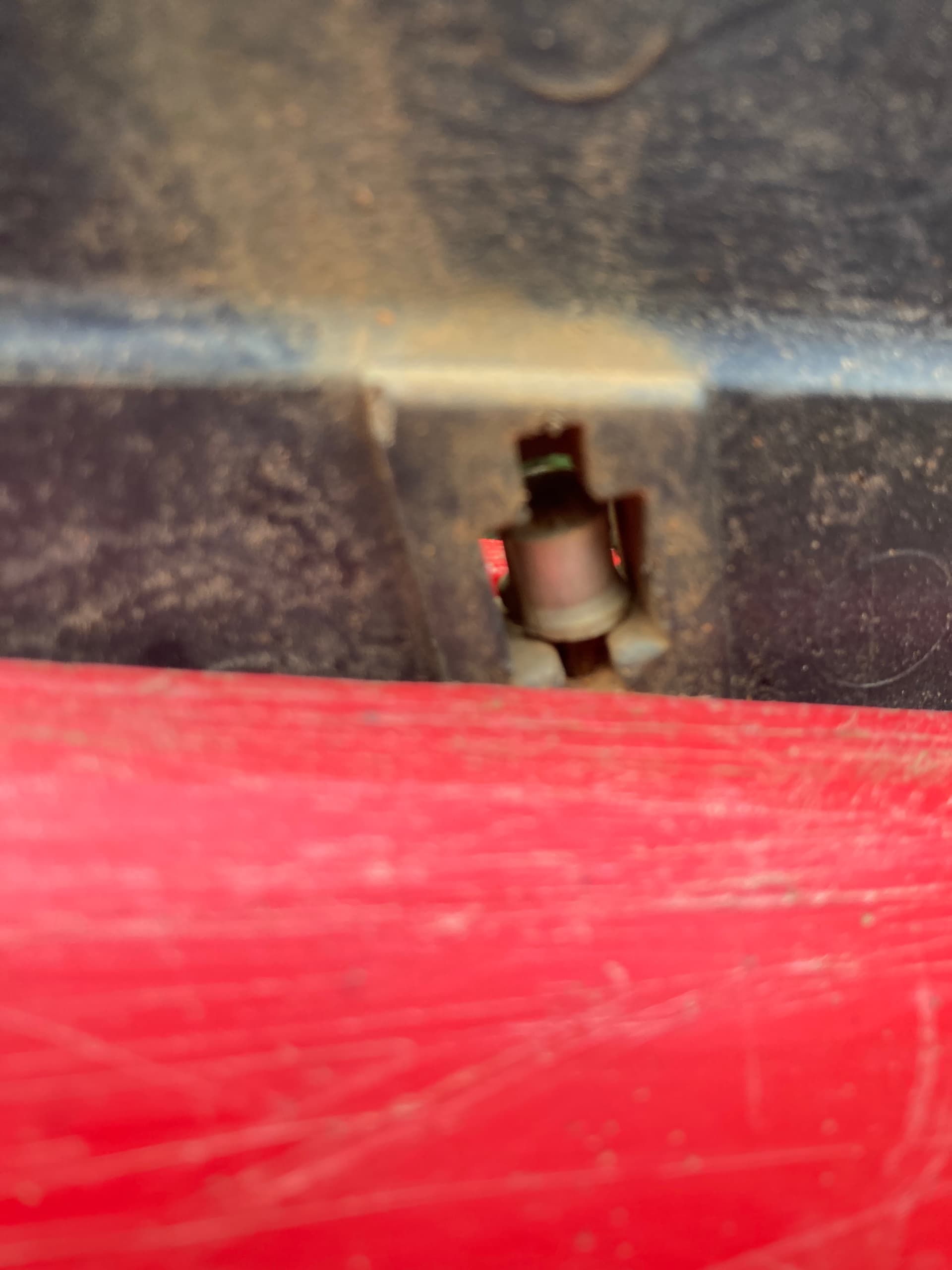

Hey guys and gals, picked up a Dagger Alchemy 14L a few days ago. Good used condition overall except the retractable skeg won’t go down using the cable, up is no issue.
I know I’ve read in a couple places the skeg cable set-up was problematic on these yaks.
Any tricks I can try or am I looking at a cable replacement? It does have a bend at the control end so I’m assuming that’s likely the problem but I’d love to not have to replace it it there’s anything I can try.
Thanks all!
First thing first, check to make sure there isn’t a rock stuck between the blade and the skeg box part of the hull. Not likely given that you said it goes up ok. But best to make sure as this is real easy to do. You can pop a stuck rock out with a screwdriver or knife.
Looking at the skeg cable in the picture you attached and how it has a bend, does look like a replacement cable is in your future.
Note - once you fix it, get a feel for how much pressure you need to move skeg up or down. If it ever seems harder than that, don’t force it. That is what bends skeg cables. Find what is preventing it from sliding easily and fix that.

I have an Alchemy 14L and the skeg gets stuck very easily. In my opinion it’s a poor design that was improved upon with the Stratos, which has a spring-loaded skeg. Mine bent in the same spot as pictured, and I had to replace the cable. I used stainless steel cable from the hardware store but had to cut down a fitting for the end to make it work. Major PITA!
What kind of fitting? Any chance you could post a pic?
This is a swage fitting, but I had to cut it down lengthwise to fit. It requires a swage tool, which clamps the fitting around the cable. Total PITA.
