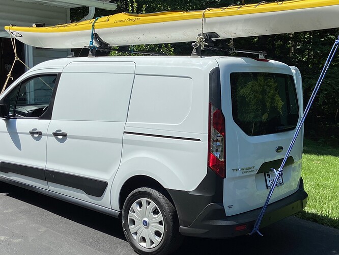

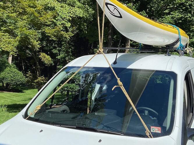

I ended up tying off to the hinges. Thanks for the suggestions of that. There are solid-looking bolts in the hinge area, they are covered in a thick layer of paint which I decided not to disturb. We’ll see how the tie-off to the hinge works before going there.

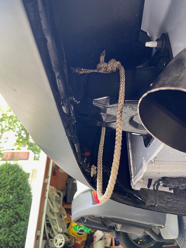

I also hung a loop around the rear bumper supports, a 3" square horizontal pillar between the bumper and the frame.
Best news yet, is that I went boating today!

also, you may have some d-rings inside, in the back of the transit. You can use those and extend the cord out through the hatch. This way the rear tie downs won’t rub on the plastic bumper.
Look into the Rhino Rack Universal Side Loader, that will make the height easier to deal with. We used that before we got the Hullavators.
And is that rope? Oh man, cam straps are so much faster.
