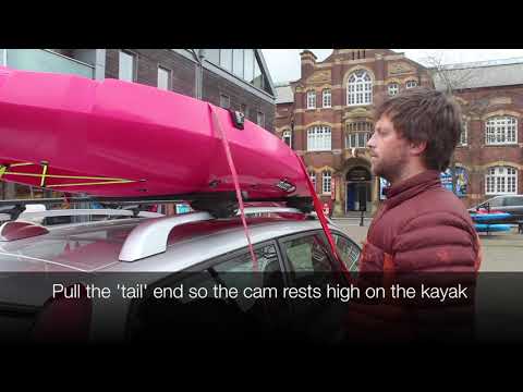

Cheap J cradles are an accident waiting to happen, which could be very tragic for anyone traveling behind you. What kind of kayak do you have? If it’s plastic, you can probably just strap it upside down directly to your cross bars. Since your bars are angled, pads might be helpful. I recommend NRS cam straps - they do not stretch and they last a very long time. There is a method for doing this properly which isn’t obvious from guessing. Here is the way I do it with my whitewater boat:
For a sea kayak I use Marco saddles with the boat upright and with additional bow and stern lines.
well. that seems simple enough. Didn’t know it was that simple! I dont have a Kayak yet, i wanted to get the roof rack going first to make sure i can cargo the Kayak first… Can’t buy a Kayak if i cant transport it… i have a bunch of ratchet straps and bungie cords. i guess putting the Kayak face down and then strapping it in tightly would work. if anything ill buy me some NRS cam straps then. Thanks for this info!

Do not use ratchet straps or bungees. Ratchet straps will likely damage your kayak, and bungees stretch so are entirely unsuitable for securing anything to the outside of a moving vehicle. Use cam straps.
ok good. thank you for the advice… Are you able to recommend me a good pair?
Yes, NRS straps. Wider is better, but the 1 inch wide will suffice. They make them in various lengths. I think I generally use 12’ long straps for a single boat, but I am not sure. You can always make them shorter (cut and singe) but not longer if you guess wrong. You can order direct from NRS with no shipping charges. Please keep in mind that how you transport your boat depends almost entirely on the boat. Not all boats can be transported top down on bare racks. And, in my opinion, saddles are preferable to J cradles for those that cannot.
Thank you for posting that Pru. I really didn’t want to load a boat in the rain to demonstrate a strap tie down.
