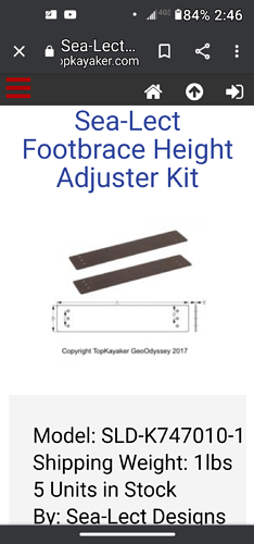

Forget if its Keepers or something
else that is black plastic from Wilderness Solutions maybe ??? One of them.
The adjustment is asymmetrical … So can pull rail out, slide foot peg off and 180 both … Re-install and you gain an I think its two clicks in other direction.
