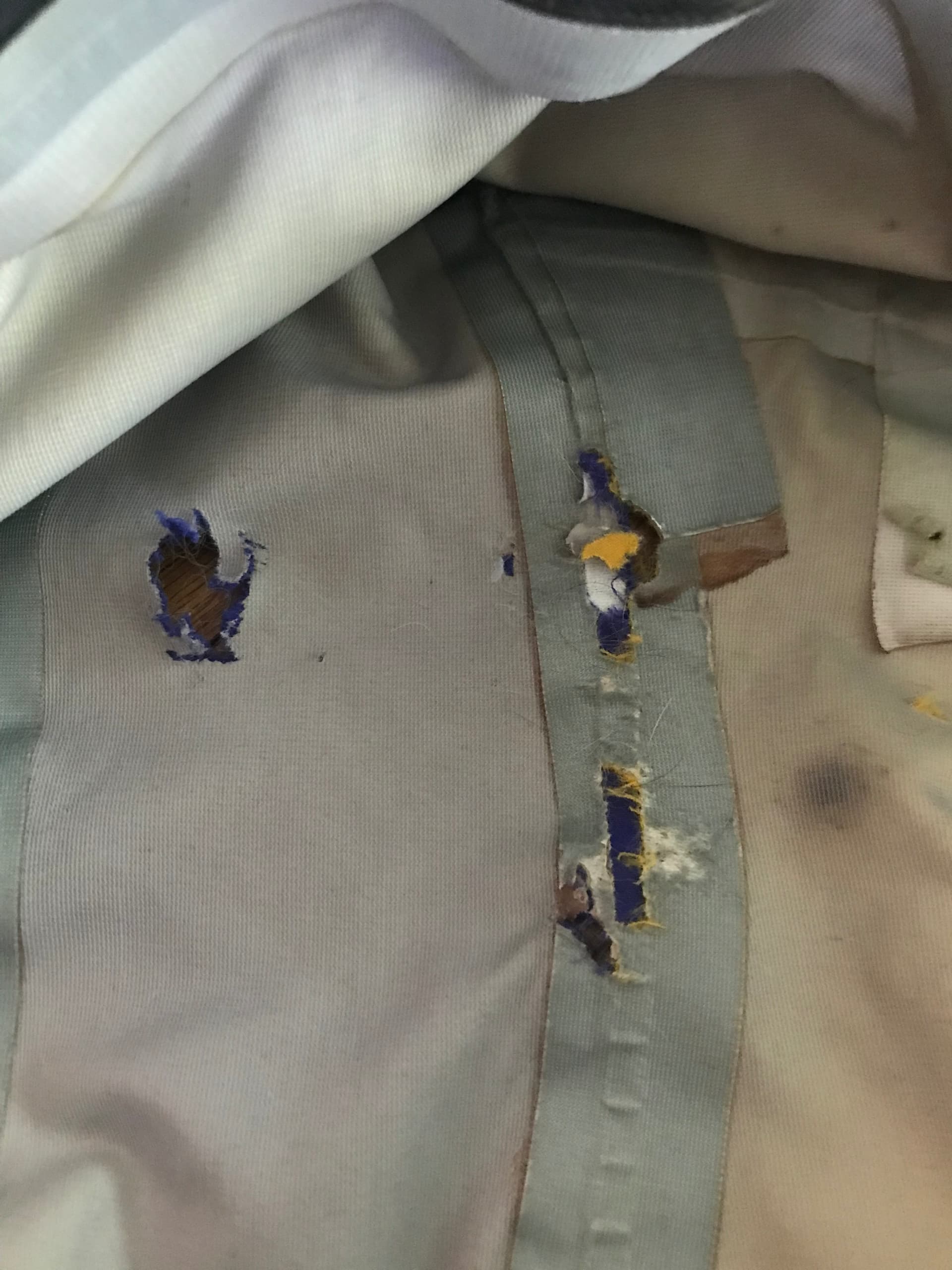

I’ve come across a Kokatat Dry suit that has some damage (small holes and tears). Also the finish on the inside of the zipper appears to be cracked and peeling. I believe the gaskets were replaced once and they appear in good shape. of course I have yet to try a submerged test.
Is this dry suit potentially salvageable? Thank you.
Not an expert, don’t even own a dry suit. When I saw the first pic I thought rodent chew, easy patch. But the next shots with seam and delamination problems, no way.

Send kokatat pictures and just ask them. I’m guess not repairable. I had a 7-8 year old suit I put new gaskets in it. Then noticed two inches of seam tape lifting. They wouldn’t repair it they sent me a new one . Your’s is much much worse in multiple areas. It could be your life at stake.

Cut the patches with rounded edges, of course. for cuts like that I would put a patch inside and outside of the tear.
By the way, I have been unimpressed with the peel and stick seam tapes I have tried – they just don’t hold well. Painting seam sealer or thinned Aquseal on is a better option, might work to paint that on the seam tape just to use it as an abrasion protection layer to the sealant film.
For that peeling zipper, I would use a small paint brush to slather a couple of layers of Aquaseal on it – you can thin the stuff with acetone (nail polish remover) but apply it quickly before the solvent evaporates.
