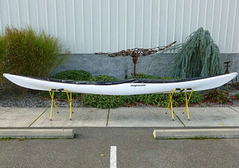

What’s a rocker?
Roughly how the bottom of the hull rises from the center towards the stems. Racing hulls have minimal, most hulls have some, and whitewater hulls tend to have a lot.
for example, lots of rocker:
