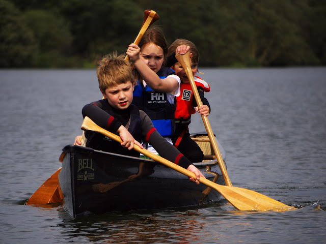

Ps. We’ve had 3-up in the Flashfire (all juniors, the larger two being novices): the only reason they eventually went in is because my daughter eventually got bored with being the right way up and did everything she could to flip the canoe. Photo (upright): http://lh5.ggpht.com/_myBUfIlhcIU/TCPToIzh_nI/AAAAAAAACvI/wMkaJWcEsGk/s640/Weybread%2001.jpg
