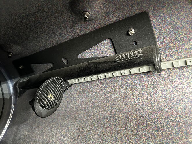

I recently acquired a Jackson Journey 13.5
The kayak has all of the rigging for a smart track rudder from the plastic tubing for the toe controls and rudder deployment line, as well as the smart track foot pegs and tracks and cords for deployment control. What would would I need to get a rudder installed and back in operation with this system? Below I’ve attached some photos of the rigging on my kayak.

I’m assuming the two nylon ropes above the thigh braces are for deployment/ retracting of the rudder?
Smart Track also makes fixed foot braces for non-rudder kayaks. It looks like that’s what you have:
To get a rudder, you would need a complete rudder kit, maybe like this one (there’s a cheaper one but it’s sold out):
Plus you would need some sort of mount for the stern of the kayak. Maybe like this one:
I don’t know if the example items I listed are the best for your use. I just chose them as examples of the types of items you need.
I wouldn’t invest that much in that kayak, but if you want a rudder you might try a cheap kit like this (you still also need a separate mount for the stern of the kayak):

Your Journey has different molded in shapes at the tail than I’ve seen before (not that I’m an expert), but I think it has a non-standard attachment. You might have difficulty getting a generic rudder attached to it. Also, the official rudder kit from Jackson, at $200, really isn’t that expensive for a slam-dunk solution.

I would not recommend a Smart-track rudder system. Instead I would go with a Sea-lect system. They’re pretty much interchangeable as far as mounting. My wife started out with a Smart-track rudder on her QCC600 kayak as it was included. We went through 3 sets of cables due to the way the footpegs route the cables. There are too many sharp bends. Further, the aluminum foot assemblies corroded in salt water and the bolts froze making installing the new cables a nightmare. We switched out the pedal assemblies a few years ago on the advice of Annapolis Canoe & Kayak and Topkayaker and have had no problems since. The Sea-Lect rudder kit comes with all parts and complete installation instructions.
The Smart-track rudder itself was fine. We left it in place, but the Sea-lect is probably fine as well.

To answer some questions, I don’t kayak in the ocean so salt and corrosion are not concerns for me. I kayak about 2-3 days a week 10 miles is my average outing. I don’t intend on using the rudder to “steer the kayak”, I intend on A: occasionally using it like a skeg to improve tracking in windy conditions B: very rarely correct for weather cocking in the unlikely event I run into unpredicted/unforcasted weather. It seems counterintuitive to tell me I shouldn’t bother with a rudder since I have a “short” 13.5’ boat when I see 9-12’ fishing barges with rudders all time, and the shorter the boat typically the worse they are at tracking straight.
That said, I’m not looking for a discussion or lecture on rudders and boat lengths, rather input from anyone familiar with the Smart Track system since I can’t seem to find specific model numbers, diagrams or schematics anywhere online and their website looks like it hasn’t been updated since 1997.
My boat already has smart track foot pegs, they just don’t have the toe pedals. The stern has two nylon threaded ports. All of the cable housing is already installed. I ordered the toe controls and steel cables. I emailed Jackson to see if they can give me more info on what particular model the boat is set up for, but I’m not holding my breath on hearing back.

Jeremy, your kayak seems to have the two holes for a specific housing. Watch this video.
and here is a usual site to buy.

I stand by my experience that the Smart-track padal system, as designed, puts excessive wear on the cables leading to premature failure due to the way the cables are routed.

I have smart track on my 15’ yak and wish I had the slider system like my other kayaks.
