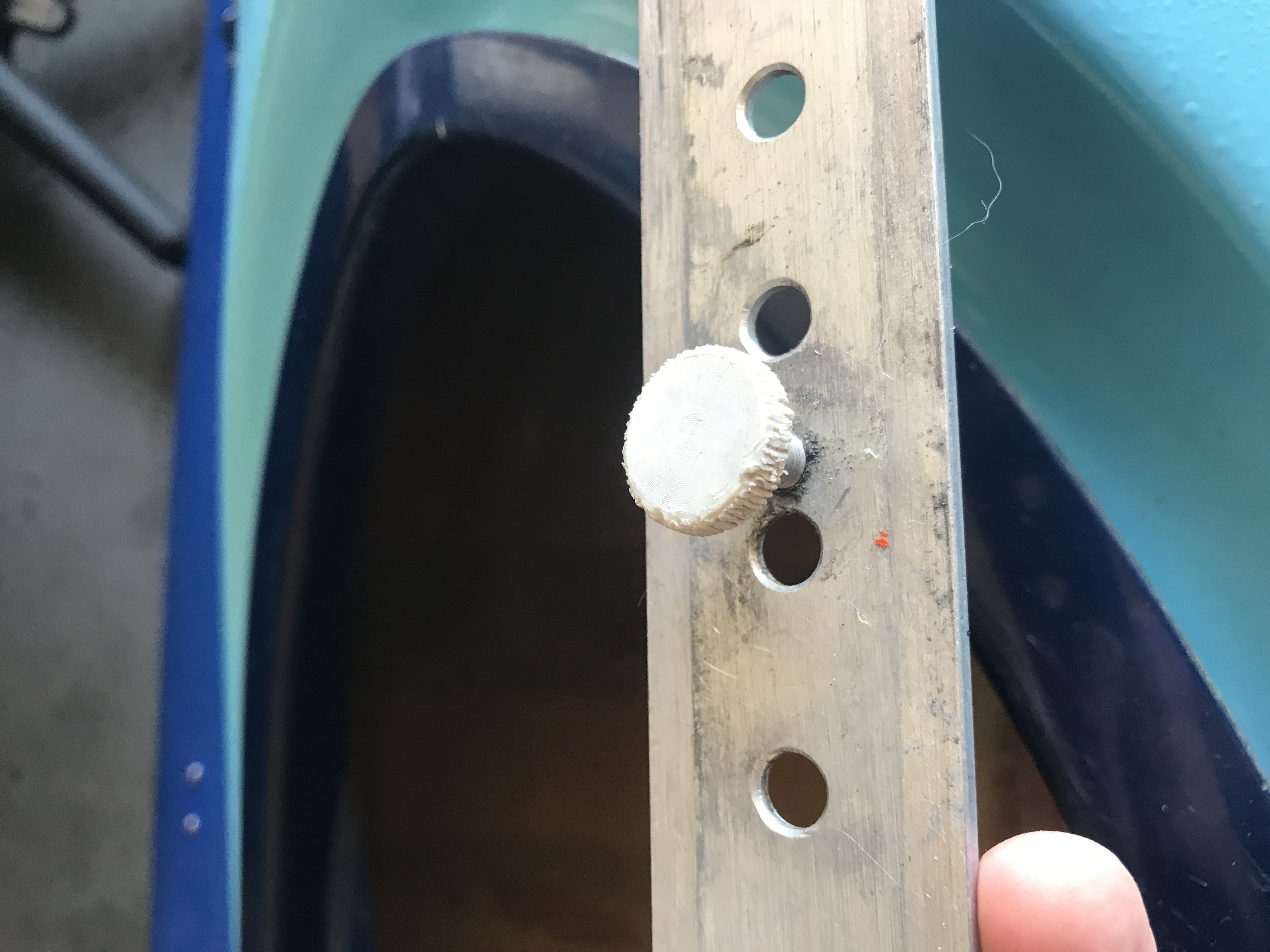

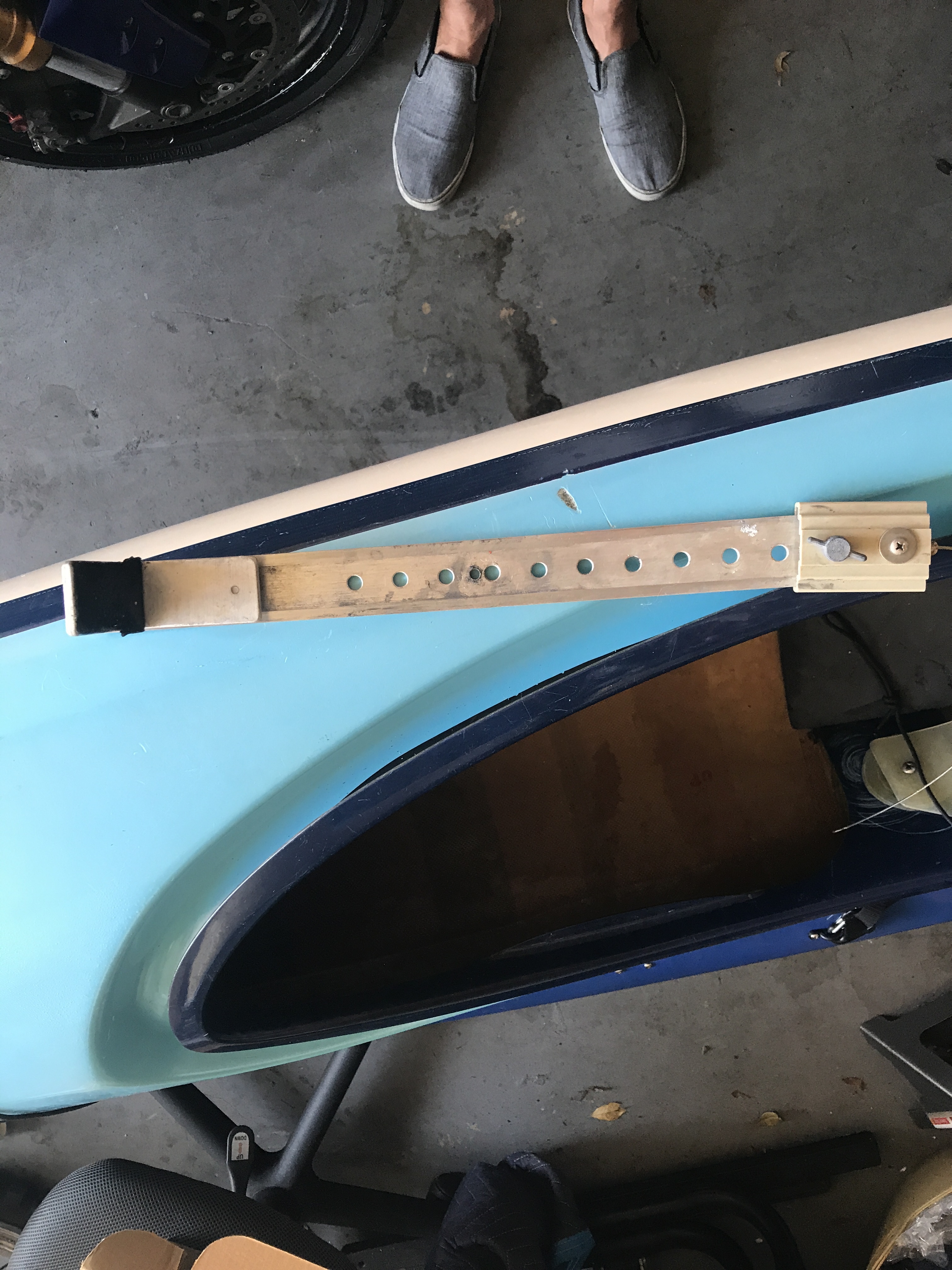

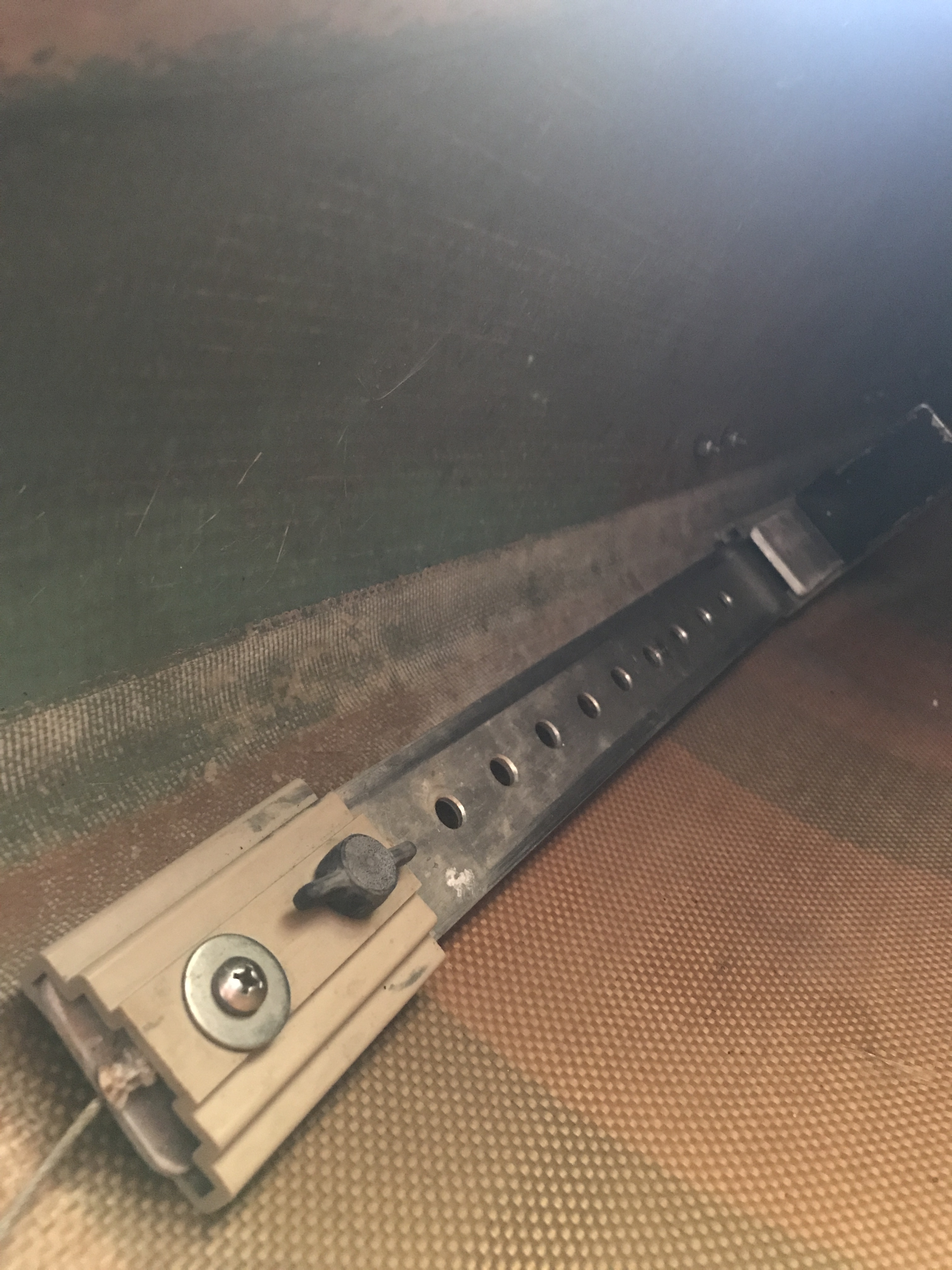

It looks like the short part with the Phillips screw and a black (plastic?) thumb screw is meant to move to different positions along the aluminum bar with the holes by engaging the black thumb screw in any one of the holes. Is that correct? If so, that’s how you adjust the foot pedal position. That other round thumb screw looks like something someone added and I don’t think you even need that.

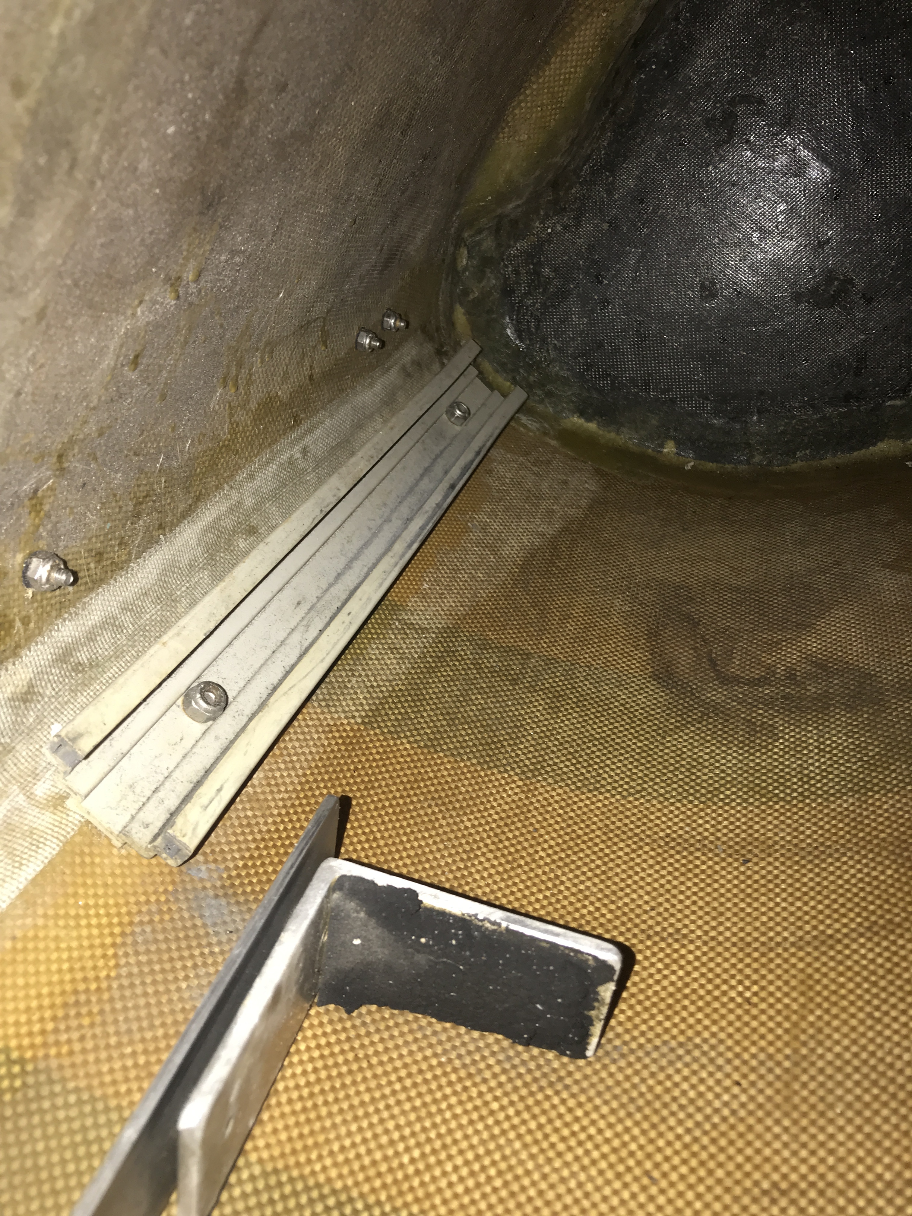

That’s a rudder cable attached. The peddle doesn’t latch anywhere. It floats controlling the rudder. Screw is likely peddle attachment. They balance between the two feet.
As Overstreet said, the foot pegs in the Arluk are not fixed. They slide back and forth to control the rudder position. The foot peg position is controlled by adjusting the strap that changes the cable length when the rudder is parked. The only way to fix the foot pegs is to not use the rudder and leave it parked in the stern bracket. The rudder pedals are kept from sliding back by a pair of bungees on the back side of the pedals to the front of the track.
