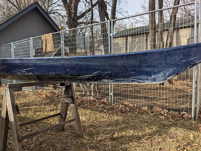

Definitely needs some work repair work. There’s some deep gouges in the bottom, but the worst of it’s what’s on the side in the las picture above. None of fiberglass material is cracked through thankfully. Never done any of this sort of work before, but this’ll be a cheap boat to learn on.

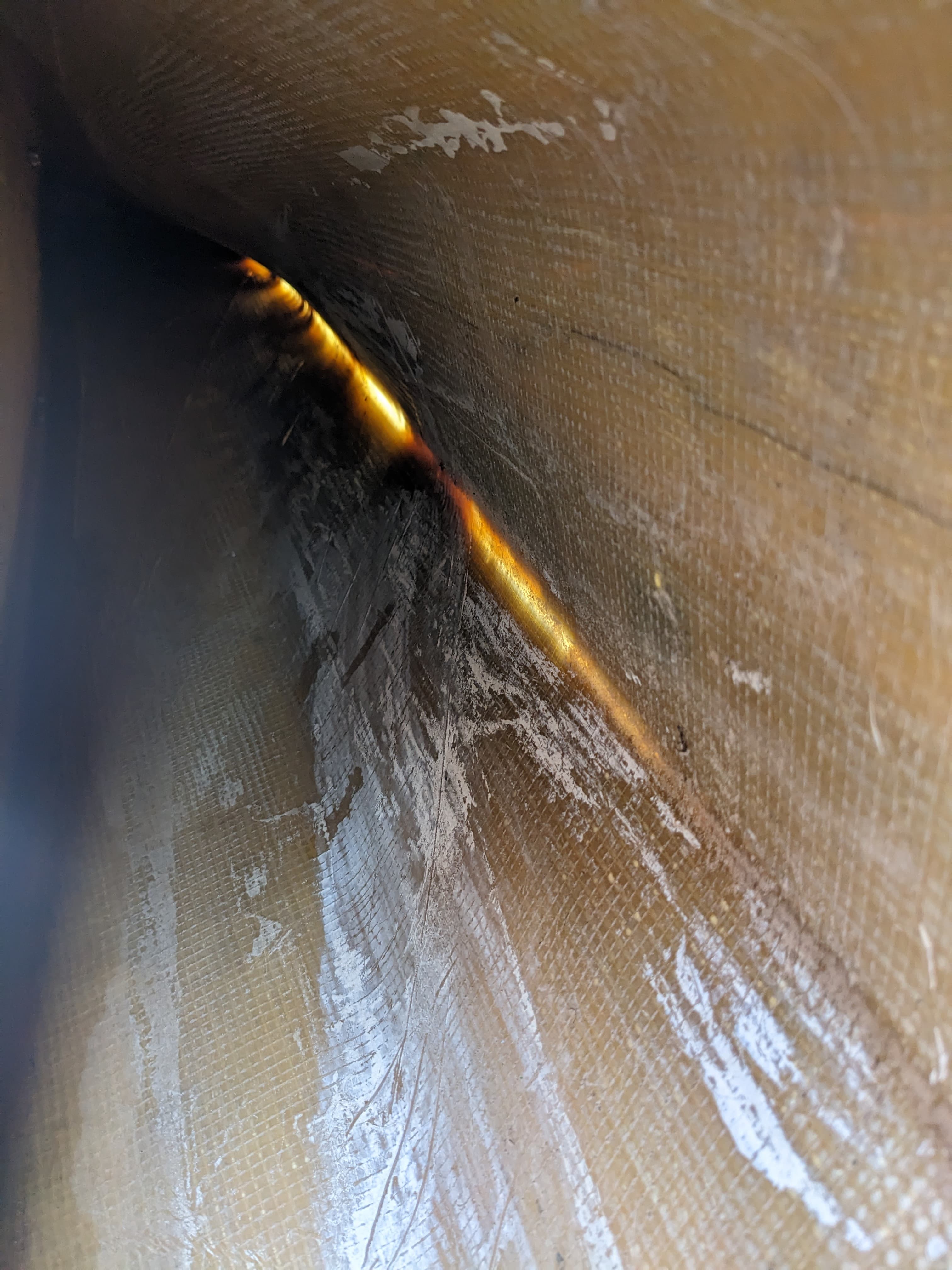

Some more pictures of it after it was thoroughly cleaned. Nice paint, but I reckon the bottom will have to be redone. Can see light through some of the scrapes (material isn’t cracked or worn through yet).
This boat appears to be FG to me but I’ve seen some articles/posts refer to it as kevlar. Not sure which is correct. Does it really matter which it is as far as repairing scraped up spots goes?

Speaking of repairs, your Hawk is fiberglass, not Kevlar. The fiberglass lay up always looks yellowish like that. Much easier to patch than Kelvar! The only solvent for Kevlar is 130% fuming sulphuric acid (I worked in a polymer chemistry research lab back in my 20’s and used to have to dissolve the stuff for experiments).

And thanks for confirming what material my Hawk was made of. I was assuming it was fiberglass but I’ve never worked with Kevlar so I wasn’t sure what it might look like (outside of the felt strips you see used for skid plates). And yeah, I’m happy it’s FG after hearing what it takes to work with Kevlar.
So the reason I dropped this in advice is because there’s no shortage of posts on boat repair with varying opinions on what products and methods should be utilized, and I’m hoping coalesce what I’ve learned into a single place to have what I think is my process forward vetted. I’ve read a number of them and I’m still going to read some more before I attempt to do anything, but at the moment I think what I should do about the big thin spot on the side next to the cockpit is:
-Sand the surrounding area down to the base layer/FG
-Thoroughly clean the area with acetone or alcohol
-Cut some dyneema to overlap the originally exposed and weakened area by 1.5-2"
-Wet fabric with g-flex and apply to area, smoothing as needed
-Lightly sand smooth after touching up as needed
Then it’s moving on into sanding down the rest of the hull in preparation for filling gouges with g-flex, getting it all smooth’ish again, and repainting (gel coat?).

Anyone know how many layers of FG were used by Wilderness Systems when building these boats? Honestly looks like a single layer of resin over a single sheet of 1/4" mesh.

@DeepBarney, they were made in Kevlar and fiberglass 38 ls and 43 lb. I believe I recall owners identifying Kevlar as a yellow weave. There are threads about specific repairs. Sounded like a cult following for thst boat
