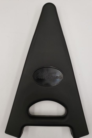

I recently bought an excellent condition OT Allagash 164 canoe. It’s a 2003 model, later renamed as the Penobscot 164. I’m all done reconditioning it and am about to replace the brass bow OT deck plate. I drilled out the 2 rivets holding it in place. One almost fell out from corrosion. Any suggestions on re-riveting the new plate on that OT sent me? Proper rivet size? Are 3/16 rivets overkill? Do you know what size OT used at the factory? Thanks in advance!

Don’t quote me on this, but I think those deck rivets might be 3/16". I was digging around the internet last night and ran across info on replacing the decks and even kits for sale (w/ rivets). I’ll see if I can find that again and post here. That said, you’ll want to drill new holes and rivet in to them for the best, most secure fit. So, you can go with what you have, as long as they’re long enough. I’d think that 3/16’ would be more sturdy, given that those rivets need to support 1/2 the canoe’s weigh when carrying it by the integrated deck handles.
Not sure if this is the correct deck for your OT (they make several different ones), but here’s the link which mentions “14 ea. AA116D Rivets”. Not sure what size they are, though…
I’m reusing the old decks. My decks and gunwales are white vinyl, which they don’t make anymore. The decks are in OK shape, but the gunwales really need to be replaced. Once I drill out the rivets on one of the decks, I’ll measure for the new ones

My OT uses 3/16 diameter by 1/4 long rivets and on the first side, I was able to reuse all holes. One got a little messed up on the deck, but the new rivet appears to be holding OK.
I’m using basic Arrow rivets purchased at Home Depot/Lowe’s and a simple, manual rivet gun.

Lol. I completely misinterpreted what you were replacing. I was talking about the entire deck, not just the name plate
Yup. Just the brass deck plate. That’s the term OT uses, from when I ordered it from them. By the way, if you ever have to replace one, they’re 1/8" rivets. LOL.
