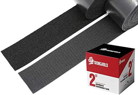

Meanwhile, I need to start thinking about how to mod the cockpit for better padding. I’ll need thigh and hip contact, and it will need to be removable. I’m also considering a foam pad for under the seat to lift me up a bit too, though I don’t feel like it needs to be too high.
Any advice on what kind of foam to use, where to buy it and what to use to secure it? For instance what about industrial strength velcro?
Another reason it should be removable is I’ll need to replace it as I lose weight too…

Closed cell foam (minicell) is what’s used in cockpit outfitting. Normally secured using Weldwood Contact Cement.
http://kayakoutfitting.com/index.php?main_page=index&cPath=15&zenid=6a40f00ad7f60d3e6f41682fb5965093
The challenge is going to be that split cockpit. If you meet up with sing or johnnysmoke, am sure they can give good advice after seeing you in the cockpit. Otherwise seek it at the NSPN session.
For temporary adhesion while testing out cockpit modifications, I’ve found heavy duty Scotch double-sided tape works well. It’s what I used for temporary hip pads in my Prana for a few months, before I received the appropriate Current Designs hip pads.

Unfortunately there can be no permanent adhesion of padding for this kayak. The added padding will block the nesting ability of the pieces, rendering that pointless. Anything I put in will need to come out in order to pack up the boat and then be re-set when I put it together again. But if Double sided scotch take worked temporarily for you, then that gives me hope that industrial velcro may be a viable option here.
