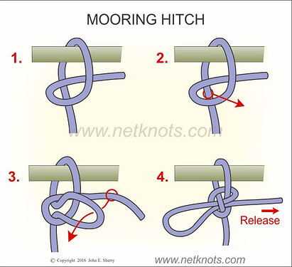

3: I am going to use a quick release knot to attach the carabiners to the rope. Here is a diagram (credit to www.netknots.com):
I am sure more experienced members will provide good suggestions for improving this :slight_smile:

Also I wouldn’t use a mooring hitch to attach the clip because you can accidentally release it when handling the rope.
@Kevburg I like the second clip you linked to, with that type, like you stated you can attach a short cord to affect a quick release. With the first type of clip, you link to (like the one I chose) you need some type of quick release mechanism.
For a quick release the mooring hitch may not be ideal, but I have found it to be ok, as long as you tie it tightly. Some sort of quick release is needed, so I am open to other suggestions.
