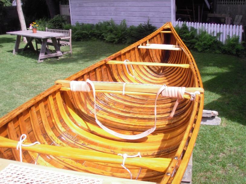

One traditional way
– Last Updated: May-08-15 7:28 AM EST –
involves lashing a "carrying bar" to the thwart with cord that is positioned to hold two paddle blades separated enough to fit your head and rest on your shoulders. The paddle shafts are lashed to the forward thwart or seat frame. A short tumpline is lashed to the thwart/carry bar in a manner that permits the tump to be used to take a portion of the weight of the canoe. This system is extremely comfortable and adjustable and enables you to carry a heavy tripping canoe a long distance in relative comfort. I find it much more comfortable the the yokes often used and referenced by others here.
Here is some info and pictures of the system but wihtout the use of a "carrying bar." http://www.amtraders.com/pricing/rigging%20a%20canoe%20for%20portage.pdf
Here is a picture of the same system with the carrying bar shown but the paddles removed temporarily for clarity. The carry bar and tump stay in place all season. The paddles go in and out for each portage. http://4.bp.blogspot.com/-9GtjkHaxaCo/UditWGky-fI/AAAAAAAAJ_U/rLX66s3SwO0/s1600/Keewaydin+WCHA+Cronje+raffle1.jpg
Once you get your systems down, and if you have the right paddle blade shape, you can tie the paddles in such a way that by moving them slightly fore and aft during the carry you can adjust so that more or less weight is on your shoulders v. the tump. So you can vary the pressure which is a great way to extend the time that you can go with the canoe up on your back without growing weary and needing a rest. I think the reason this system has not become the standard is because it does require some time and effort to get it all working well - but if you take the time with it the system really does work very well.
One of the common fail points for a thwart or typical yoke is the attachment to the inner gunwales. There is a tremendous amount of stress at that point especially when portaging. The use of double bolts helps. The use of a carrying bar completely eliminates the stress on the thwart by transferring the weight of the canoe to the top of the gunwales instead of the bolts connecting the thwart to the underside of the gunwales. So if you are doing a lot of portaging this system prevents thwart and yoke failures which can be a problem on a trip and hard to fix until you get back home.
